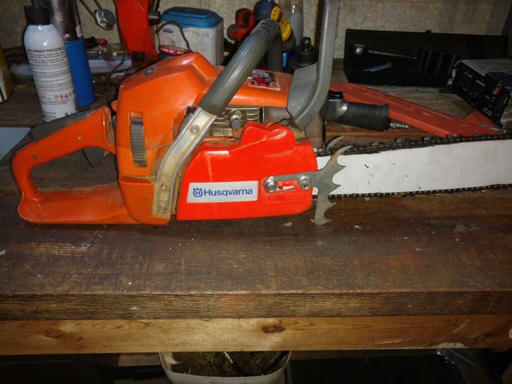

This will fix the flip flop though!!:)Screenshot_2016-08-11-03-39-36.png

This will fix the flip flop though!!:)View attachment 29964
You might find those unwieldy. Your 16 bar will turn into a 13". There are custom ones that are better.
