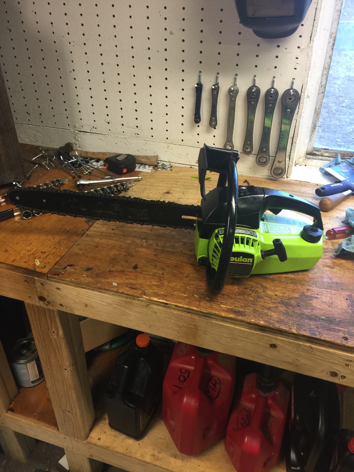

OMG this thing is frustrating. It was running halfway decent yesterday. Today, it wouldn't turn over at all. It was so rich there was fuel in the muffler. I leaned it back to about a turn and a half, and dried the spark plug, and finally got it started. Had to have the throttle open to do that. I don't know if I'm any closer to getting it tuned, or just in a different spot. I got the H lined back out and made a couple cuts. The L is hopefully a little closer. Maybe tomorrow I can give it a shot again from a cold start and see if it'll start easier.
I got this one from a guy in the Christmas thread. It's a cool little saw that'll round out my collection size wise.
It needs the same fuel side treatment I gave to these others.

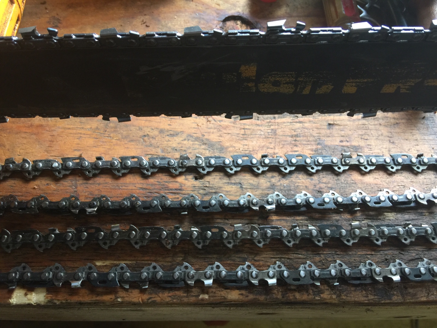

I have a chain question this time. I bought a 91vxl so I could see what a Poulan will do with good chain on it. I got to looking at the other chains, and one of them is weird. In the picture, the 91vxl semi chisel is on the saw. The one at the bottom is typical safety chain. I guess it's a semi chisel or their chamfer chisel. The middle one has two bumper links between each cutter instead of just one. Is this some kind of semi skip safety chain, or just an even more dumbed down safety chain? Gotta be safer if it has 30% less cutters, right!

21 vs 31 cutters.

Maybe I can learn to do ice sculpting with it. So, out of three chains I got with those two yellow saws, one is actually functional, and that's using that word loosely. One safety chain, another safety chain with a broken cutter, and this skip tooth chain. I'm gonna save em all. They'll work for cutting stumps and other dirty crap I don't wanna mess a good chain up on.

I haven't cut anything yet. There's ice all over my yard. It was 74 and raining yesterday. Dropped to 18 last night. High of 24 today. It looks like the LPX I have on my echo, just smaller. I suspect it'll cut pretty good.

I couldn't take it anymore. I was cleaning the garage, and the saw was staring at me, so I went and made a couple cuts. The vxl chain cuts so much faster than that crap safety chain.If you could buy these things like this one sits now; muffler mod, good chain, and tuned properly, these saws wouldn't have the reputation of being a pos that they do. Hell, if I had one that ran this way, I never would've spent the money on a nicer saw last year. I can tell you this saw will have a home with me for a while. I'll have 29.5cc, 42cc, 47cc, and 60cc. I think that's a good spread.
