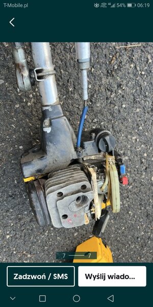

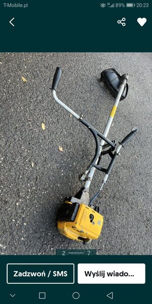

Was that a factory made brushcutter? Or one of those kits to turn a saw into a brushcutter? I could see it either way.

I have no idea 😉 How can you tell?

I have no idea myself. The machine looks like they took a chainsaw motor with minimal modification and stuck it on a brushcutter. The exhaust is still on the operator side. Stihl and I think Homelite used to make brush cutter kits for chainsaws that looked similar.

It has an interesting fuel tank and a 38mm thick pipe / Yes, it's a trimmer with heating 😉 silencer plus fan air 👍

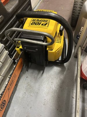

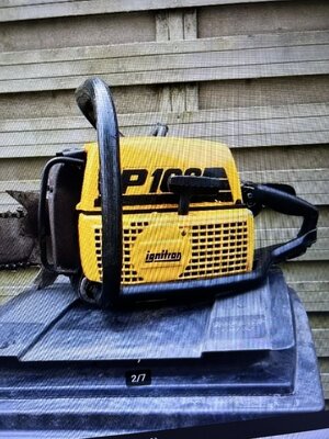

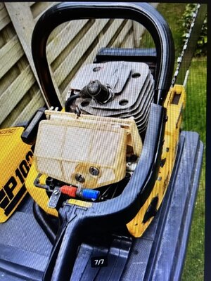

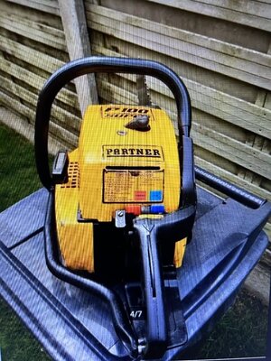

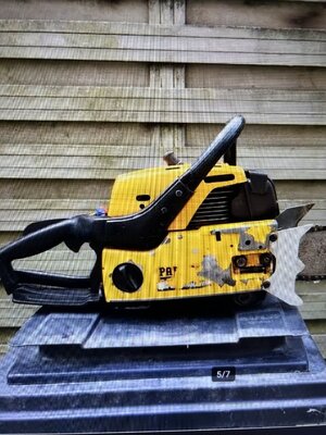

Here are picture of a Partner P100 SUPER 100cc/6 Cubic inch. This must be the last version from
Partner. Maybe made around 1981-82. It's the same saw on all pictures. What I have done so far is installed the missing the chain brake handle on the clutch cover. It's the same as the smaller 55cc Partner chainsaw. The clutch has the same parts on the P100 as the 55cc. Where can I buy gaskets for this 100cc Partner? Any one of you that now sumbody that have NOS parts for old Partner? But I just did buy this Partner P100 SUPER from Belgium. And I am from Sweden and live in the same area where the original factory was. About the same distance to old Jonsered Chainsaw plant. Swedish brand Husqvarna did buy Partner and Jonsered. All production is long gone from the Gothenburg-Mölndal-Jonsered Area. But what was left behind in Jonsered was research and development the engineering department so to speak. From what I have heard there is no chainsaw testing in Jonsered. I think GPS lawn mover or other "useless" stuff. I now this is about Partner chainsaw. But I can mention that Husqvarna will have started production of there new fuel injected chainsaw the 564 XPG FI it's about 60cc...got the stroke of a 50cc and piston diameter size of a 70cc saw. Light as possible is what the goal was, as allways i hope.

Thank you for sharing. That chainsaw is indeed super. Is there anyway you can post pictures of the old factory? Do you know any locals that used to work at the partner factory before the take over?

Magnus has a thread about the history of this company
