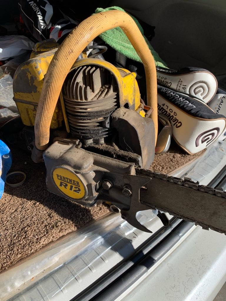

Would any of you have a head gasket for an R11 or R12? I’d like to replace the head on mine because of broken fins, but I won’t take it apart until I have a gasket.
TIA.

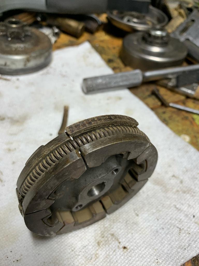

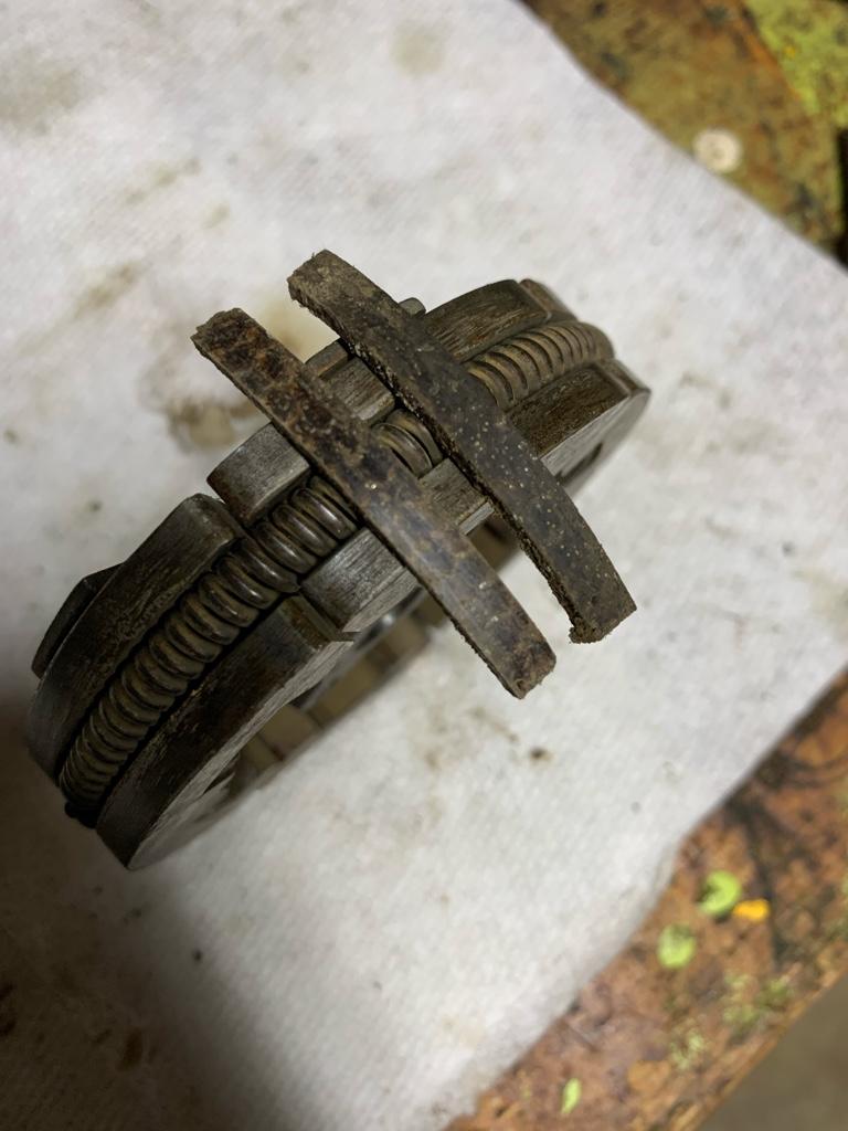

Looking for a set of clutch shoes for an R/11-R12, or a way to bond the linings onto the shoes of the one I have.
Thanks!

Thanks Kenneth! I asked two brake shops to no avail, I might try bonding them up with epoxy figuring that's how it was done in the first place. I'm guessing I can't make it worse!

Brake shoe rivets like in the old days.
U will need to drill and counter sink.

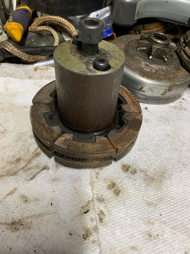

Thanks Karl, but they are too small to rivet I think. They’re more like strips and probably why they come loose.
I had one more chance on a parts saw but took 5 days trying to get the clutch off without screwing up the shoes. Finally got it tonight.
