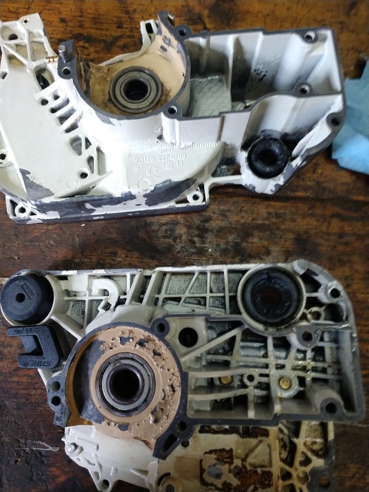

Evening fellers. Sent a couple saws home tonight. I'm going to have a buddy do some powder coating on this ratty old 044.

Not hatin, this one just has a ton of miles on it. It ran pretty good a few years back but it's time for a rebuild. The guy wanted me to paint it but I talked him into powder.
Can't decide if I should punch out all the pins for the chain brake or not before the powder coating??
Sent from your mom's house
Leave em in. Easy enough to clean them up with sand paper after. They’re not something I’d mess with. Make sure the area around the pto bearing where the oil pump seats and the bar pad area around the bar studs don’t get powdered.
Sounds good. We already discussed masking off all the machined surfaces. The powder guy was a machinist at work for years so he gets it. He's done other stuff for me and it's always been real nice.
