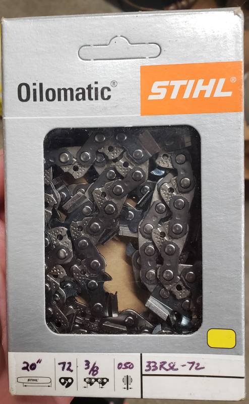

Dear friend if possible please send me the serial number and picture of Stihl factory square filled chain

I bought them from @Redbull661
Let me see if I can find the boxes.
He may gave bought bulk chain in a large roll and make them to order.
I think the Stihl square ground chain is RSL.

how long square lasts seems to depend on how it's ground/filed.
Stihl square grind seems to vary, thus I've got different results over the years trying to figure out how long it lasts vs stihl's round ground RS.
I will repeat something that @tree monkey told me. And it'll make you think. Here it is: Scott, "Square lasts longer, but round ground cuts better and longer when it's dull."
Rolls of stihl chain which I've ordered, used, tested, sold...
33RS - .050 3/8 round ground full chisel full comp
35RS - .058 3/8 round ground full chisel full comp
36RS - .063 3/8 round ground full chisel full copm
33RSK - .050 3/8 round ground full chisel full comp - klassic RS cutter design.
33RSL - .050 3/8 Square ground full chisel full comp (can be hard to find)
36RSL - .063 3/8 Square ground full chisel full comp (can be hard to find)
33RSLH - .050 3/8 Square ground full chisel semi skip (can be hard to find)
36RSLH - .063 3/8 Square ground full chisel semi skip (can be hard to find)
33RSF -.050 3/8 round ground full chisel full SKIP
36RSF - .063 3/8 round ground full chisel full SKIP (think I got this from canada)
33RSLF - .050 3/8 Square ground full chisel full SKIP
36RSLF - .063 3/8 Square ground full chisel full SKIP
46RS - .063 .404 round ground full chisel full comp
46RSLF - .063 .404 Square ground full chisel full SKIP
33RM 36RM 46RM - rapid micro aka round ground semi chisel full comp
33RMF 36RMF 46RMF - rapid micro aka round ground semi chisel full skip (can be hard to find)
