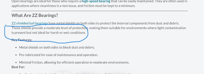

What’s your thoughts on this.🤨🙄

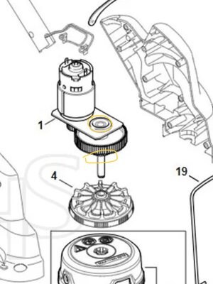

I had a friend come and ask me why her battery strimmmer started up and cutout in a few seconds.
And she said the battery was fully charged. It’s a fsa 57
I asked if she noticed any thing around the shaft ie dried grass or plastic matting shreds?
Anyway I had a look. However It was the bottom bearing seized on the geared shaft of the motor, which is sold as 1 unit for the mighty cost £85.00
The bearing is a 609 2z (c3) which is the same bearing an the top , a £3 bearing inc postage.

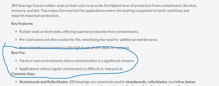

My thoughts is why are sthil using a 2zz metal shielded bearing when they should be using a 2rs rubber shielded bearing on the bottom ?
Obviously the motor needs an air flow which is helped with that plastic thing #4 above the spool.
I,m not sure if people are aware that stihl says that wet or damp grass should not be cut 🤦‍♂️🤷‍♂️
I guess that’s there get out clause.
Anyway I replaced the 609 2zz with a 2rs. It seems to be fine at the moment
