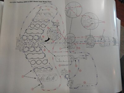

@Kiwioilboiler Looks like you are fine with your temps. Just remember when you are running with higher RPM's your vanes on the impeller will flex inward and the motor relies on the forward momentum of the boat to push water through the engine. One of the reasons they say not to run the engines at a higher RPM when in a static tank is because of this. Got you a bit of reading material as well.
