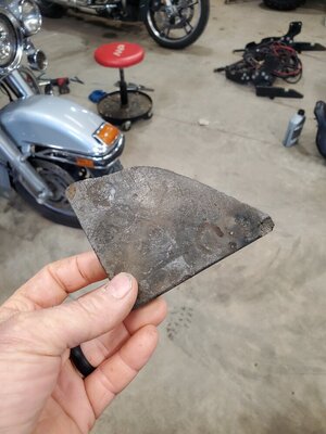

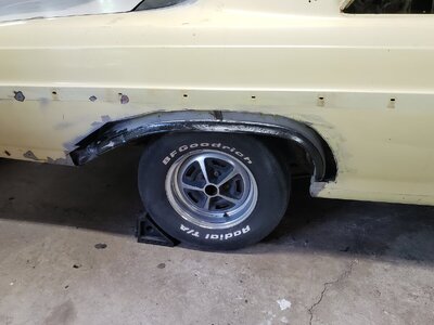

I wonder if tig would be better?
I have no doubt it would be, but I don't have a TIG.
I haven’t used it before. I did hear something about if it’s clean metal it acts goofy. Idk 🤷‍♂️
They got back to me this morning. They said it when it bubbles like that it it was either applied top heavily or the humidity was too high. Humidity was a bit on the high side yesterday and I probably did lay it on a touch heavy.
If you can get to the back side, stop by a welding shop and get yourself a carbon block.
You can hold that up to those spots on the back and weld right on it. The weld will not stick to the block but gives you a surface to weld on to fill the holes.
Good idea Ed. There's a shop not too far down the road. I'll stop by and see if they can help me out.
Copper plates work too.

There is a softer mig wire available too, better for body work. Easier to grind and planish.
Interesting. I'm using regular .024 wire.
I stripped as much of the coating off as I could, the pinholes were still filled in by the old layer, not even the sandblaster would clean them out. Then I scrubbed in like a surgeon and reapplied a very thin coating. After grinding and sandblasting the old coating off, I dont think those bubbles affected the integrity of the coating, but I wouldn't have known otherwise. So far so good, I'll report back after work.
