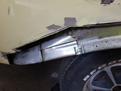

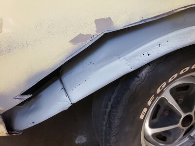

Anyone use POR-15? Ever have this issue? Looks like surface contamination but this was clean, just-blasted steel. I can't imagine how the surface would've gotten contaminated. I'm gonna blast it back off tomorrow and try again.
I think epoxy would be better.

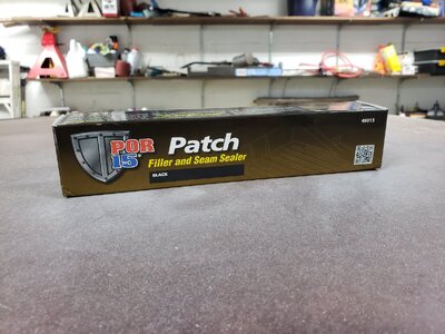

I'm thinking you're right. There are some small pinholes I want to fill and this POR-15 Patch stuff is supposed to work for that, but after this mess I think I 2k Epoxy and fill the pinholes with 2K seam sealer. It's all hidden under the outer wheel arch.
I cut out the worst of them and welded in a patch but I don't want to cut out the whole inner arch. No one repops it and I don't want to fab all that.
