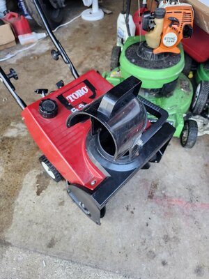

Got the little snowblower running. Perfect piston and cylinder.
Some doufass slid the carb float shutoff tab between the wires from the needle.
The baffle inside the muffler had fractured with a piece blocking the exhaust outlet on occasion.
It runs now, but it's loud.
Going to try to open up the muffler and see if it can be salvaged. Its has the Tecumseh HSK600 engine.
edit: for engine mfg info clarification.
