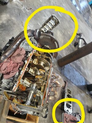

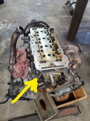

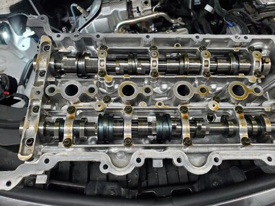

The lower crankcase is also the main bearing "cap".
I removed the bearings to clean the lower crankcase
Makes the engines pretty ridged.
Problem with these is the ran out of room to put perimeter bolts at the rear and paired with the exhaust routed right next to it causes degradation of the seals faster than they really should..
This is a 2011, but only 60,000 miles.
Segmented. Volvo was doing that with their 5 cylinders, and on and on. All sealed with anaerobic. Cam caps were the valve cover even.

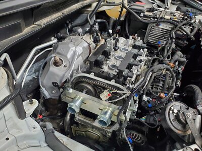

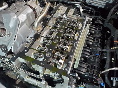

The new 4 cylinders have the cams in the "cam carrier", or what was once upon a time the cover..
These are sliding camshafts for high/low lift.
