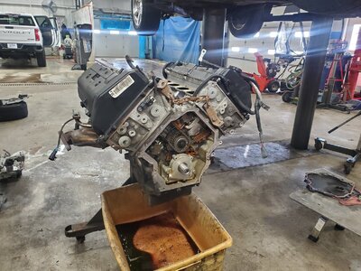

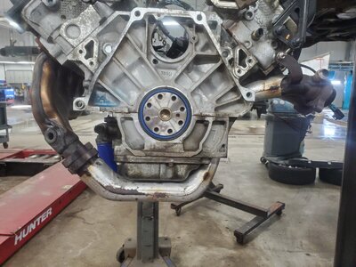

Looks like they wanted to keep the oil warm.And here's how the cross the exhaust from the front back to the rear..View attachment 413826

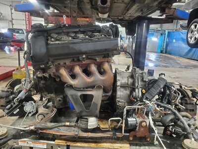

Was that seriously just about changing the starter?Ready to go back together

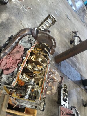

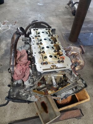

I guess I skimmed through too quicklyNo. Oil leak at the lower crankcase.
Look 7 or so posts above a you'll see where I had the bottom end split.
Pretty amazing engineering and machining Ed. So do the main caps float in the lower base assembly? I see the hardware goes through the windage tray too. Fuggin amazing.
