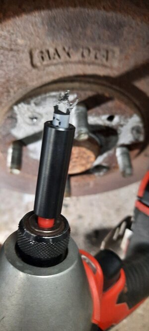

Surprisingly, the Milwaukee out torqued the supposedly "impact rated" #3 Philips bit in about 3 seconds. Probably have to drill this scrww out
Must have been that the battery was bad. Good luck getting it replaced under warranty. Milwaukee does not warranty them anymore according to the ope guru.

I did, before attempted removal, and after lol. Found the broken tip, too; lodged firmly in the screw head. I'm calling it a day on the brakes. 3 out of 4 corners with little tykes tools in 2 hours ain't bad! Gonna bring home my die grinder and a carbide burr to chew out that screw in the morning. Hate to screw up a nice twist drill hitting the hardened bit tip...

You need an old school impact driver that you hit with a hammer for those.
I am aware of that haha. I lent that set to a friend and it never came back. 3/4 of them came out with the other impact driver, so I'm still calling it a win

what brand impact bit ?
screwdriver tip in a wrench hit with hammer works just as well

That bit was part of a Bosch set I bought a couple years ago. First one I've broken.
I used my hammer-driver to get the drums off 2 years ago when I first got the car, and probably should have used more anti-seize on these fasteners. Road salt and the brine they use up here is nasty
