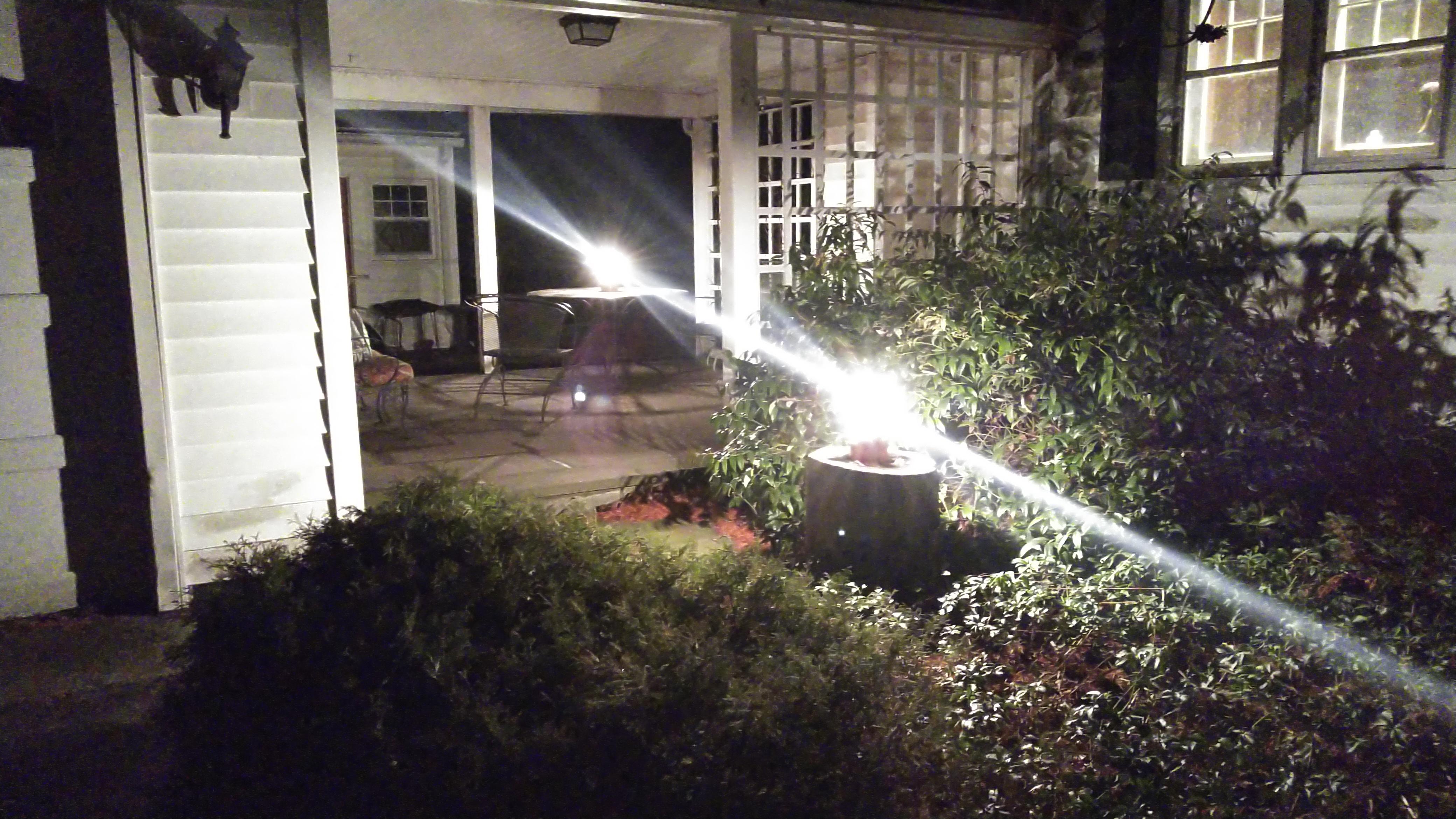

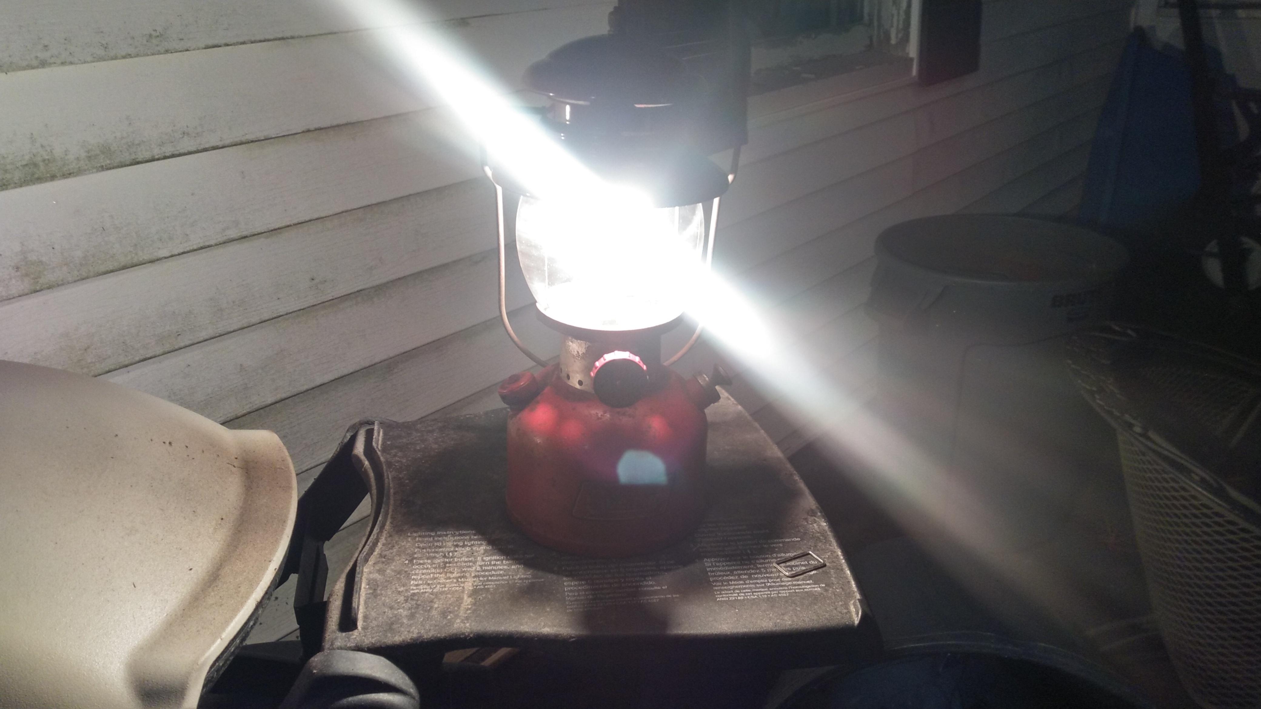

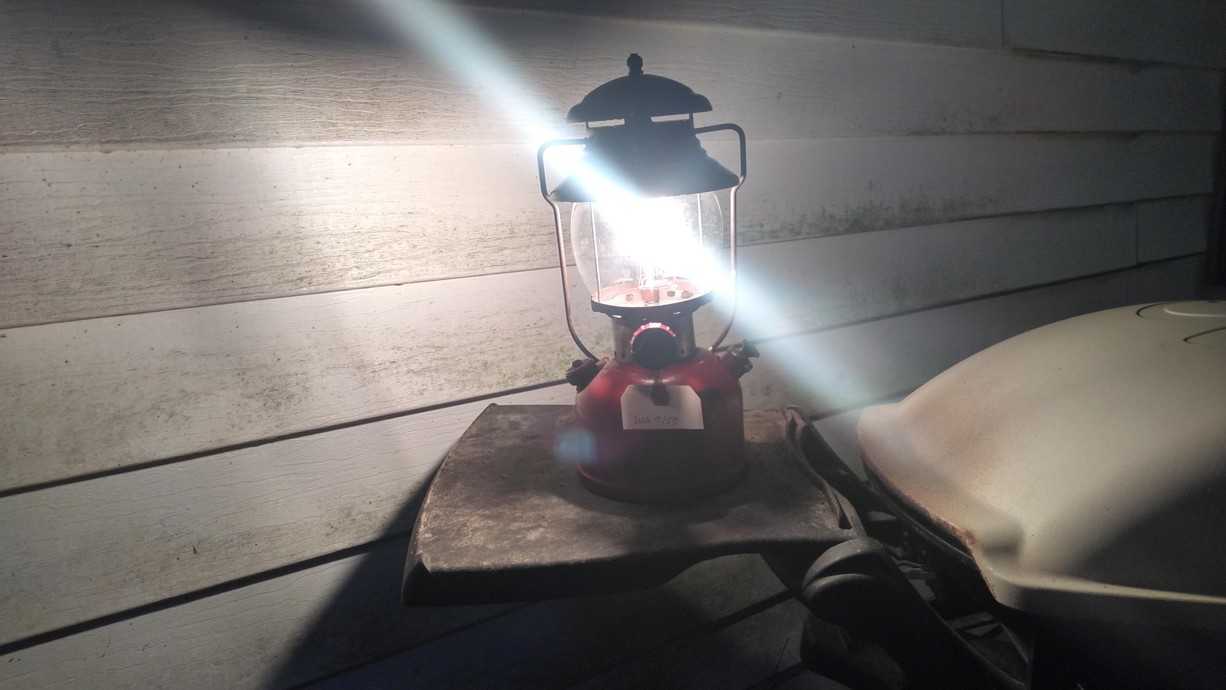

Just got these 2 burning this evening. Both 200A single mantle. One is dated 7/1955 and the other is 6/1956. They both just needed the pump leather oiled, pulled the pump check valve on both out and cleaned them in the ultrasonic cleaner, replaced the fuel cap seals, cleaned/flushed the fuel tanks, cleaned the valves and pickup tubes and replaced both generators.
