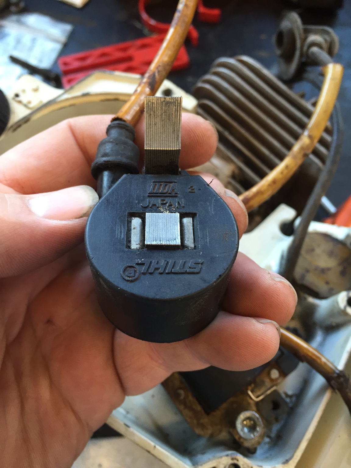

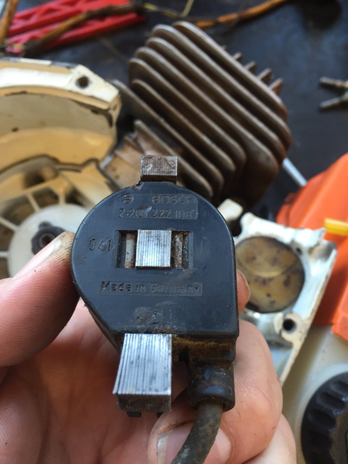

Ok so I have a few boxes of parts for 064/066 saws. I decided to put a 064 together. Everything was going great until I got to the ignition. Looked in the box and there wasn't one. I have a few coils for 066/064 and I don't know what to use. Here are the three I have
The two flywheels I have end in 1201A and 1203. I have another case and the both have the 3 screw holes. On case it looks like used the top hole and the other the bottom. I am confused. will one of the coils work. I also have a limited red light coil but I don't want to use it.
Thanks in advance

The flywheel will determine which coil you must use. Based on your picture you have the 1201 Fw which is unlimited (desirable). This means you can use the 1122 400 1300 coil. Some of the 064 crankcases also had a dual mounting pattern to also work with the 000 400 1300 coil which was used on a *s-word load of saws.

All I can tell you is that from the pics you posted the coil in the middle is for an 066 with a poly flywheel.(1314 coil) It also works on other saws. I believe it won't work on your 064.

One on the left
The right
Which would work with a 1122 400 1201a flywheel

One of my coils is a bosch
