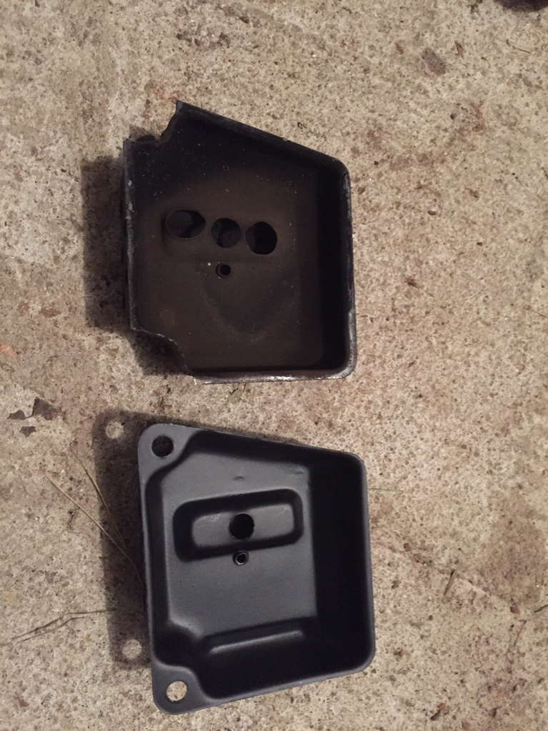

My muffler broke around the outer bolts so had to get a new one and mod it.
Here is a pic of the old one and new one pre mod. I am just a hack so they aren't pretty

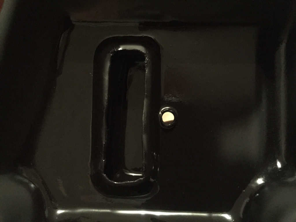

Here is after my mod to the new one
The paint is still drying!

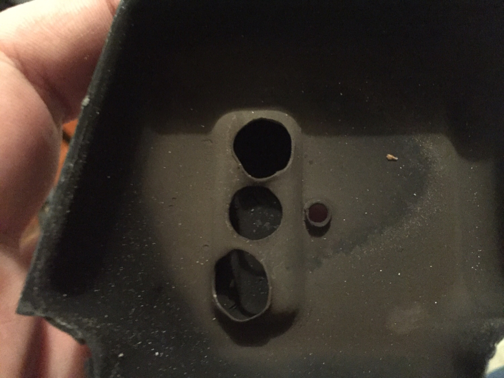

The old one close up

The old one I took a 3/8 drill bit and made 3 holes the 2 new ones twisted as they went through deforming the holes.
The new one I couldn't find my drill bits so used the dremel I now have and cut the hole.
There doesn't seem to be many pics of mods for new people to see on here or I can't find them. Figured I would put mine up since I had to redo it.
