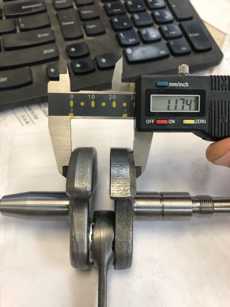

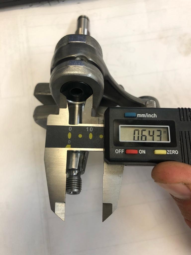

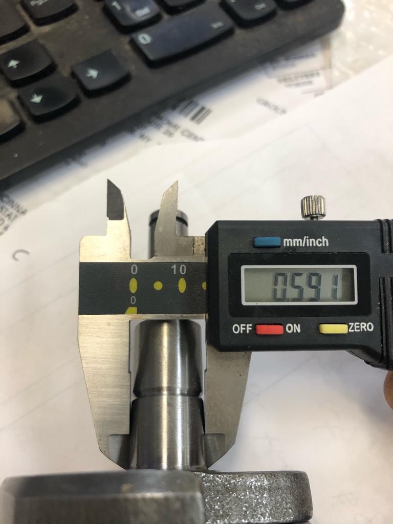

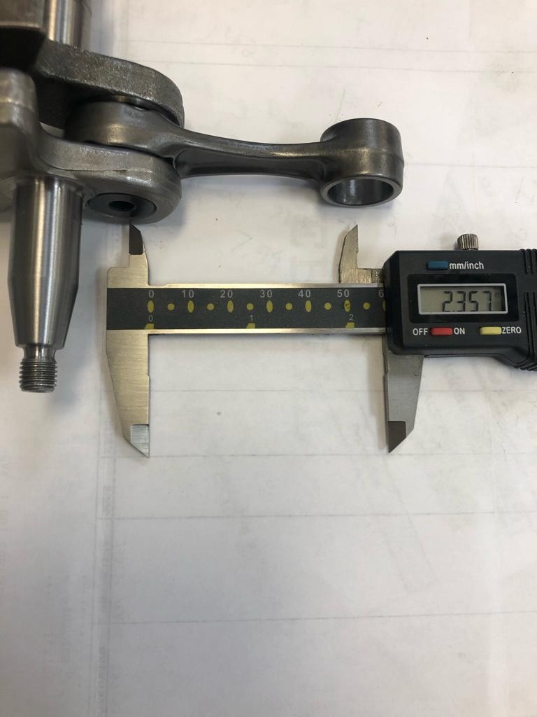

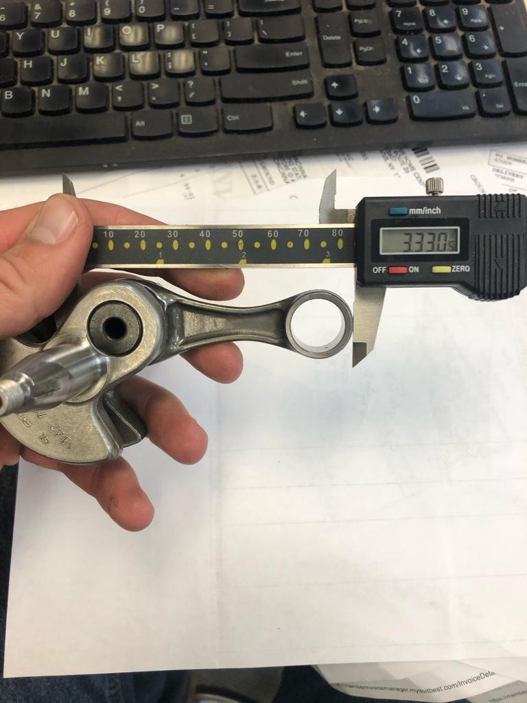

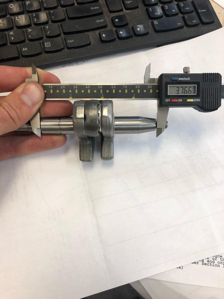

Well bummer. Looking at cranks from all the saws in this category, anything with a 1 or a 0 on the end of the model number, all have a step in the shaft on the flywheel side. I was hoping it would be the opposite. Having the 462 crank a little smaller than the others allowing it to be turned down to match up but that's not the case.
Oddly enough a 362 crank looks really similar. In pictures. And it shares the same stroke of 34mm. But, pictures can be deceiving.
I wish I lived in chainsaw country where there was a good shop that had some dead saws I could poke through but that ain't the case here on the gulf coast.
You should see the looks you get when you go into the dealers around here and start asking about 70cc saws. Most only stock up to the 60cc variety. You might find a 362 but its mostly farm bosses and ms250's lol.
So, I guess this project is on hold for the time being. Unless somebody has any ideas ? Looks like a base cut and squish mod for now.
