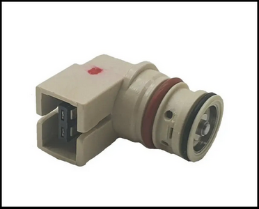

The solenoids are replaceable, if I remember correctly they cost around $40. If that is the only issue, it is a relatively cheap and easy fix for that saw.

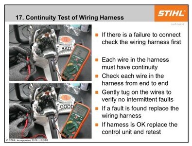

This is from using the MDG1 Diagnostic tester Procedure.
If there is a failure to connect then the wiring harness needs to be checked for continuity at each wire end to end. Someone mentioned this. I have seen multiple M-Tronic units have a failure in the harness, and I don't think you mentioned having done that yet. All of the wires have soft coverings and there are little grooves in the plastic to route the wires properly. STIHL makes a special tool (of course) for push in the wires into the grooves. It is basically a blunt smooth corner screwdriver so you could make one. If the harness is out of placed or a wire got pinched this may be your problem.
