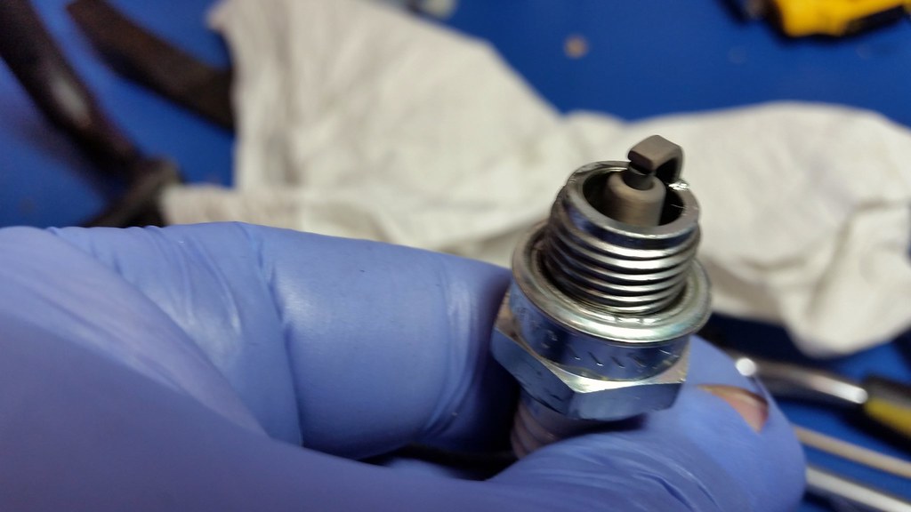

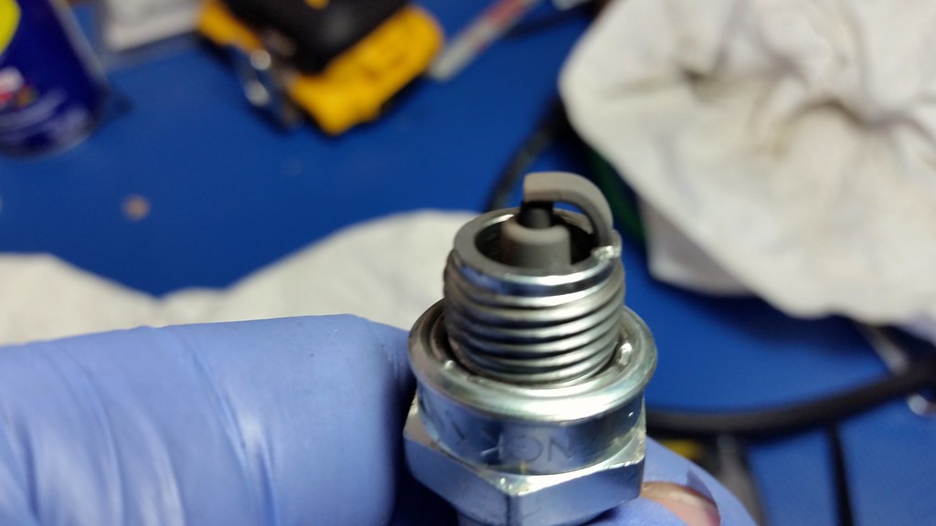

Made some cuts with it again this morning. It sure sounds lean to my ears, but I don't really know what I'm talking about anyways.. Maybe it's just an Mtronic thing.
I cut a few cookies and killed the saw mid cut on the last one.. This is what the plug looked like. New plug with about 10 minutes run time. Any thoughts? I'm thinking it looks ok. I pressure/vac tested it again and all holds well. P&C looked good and were wet.

Hard to say from plug pics. I don't usually trust plugs as the only indicator; theyre part of the story, tho.
Got a tach? My cousin's 441 sounds a bit lean wot and is what I call a bit high-strung. He said he tached it at 13,000 tho.

Thanks guys. So do the Mtronic saws not four stroke as clearly out of the cut since the carb adjusts itself for max rpm always?

The one's I have ran seem to rev limit and not four stroke. These saws are set as lean as possible.
That's kinda what I was thinking, thanks for confirming that. No air leaks and it seems to run and idle steady so I guess I should just trust the technology and run the thing and see what happens!
Yep! Might take a gander at the piston and cylinder if you aren't certain. You try moving it side to side and picking it up and setting it down to see if there was fluctuation?

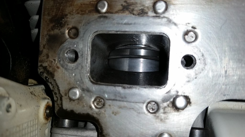

I did pull the muffler when I checked that plug, P&C looked good, still wet. I've flipped that thing all over and around, no fluctuations. I need to get some big wood under it and run the thing for a bit and check the plug, P&C again but I think I' good to go. I was just worried as I'm used to hearing four stroking at WOT, eases my mind knowing the Mtronics dont.

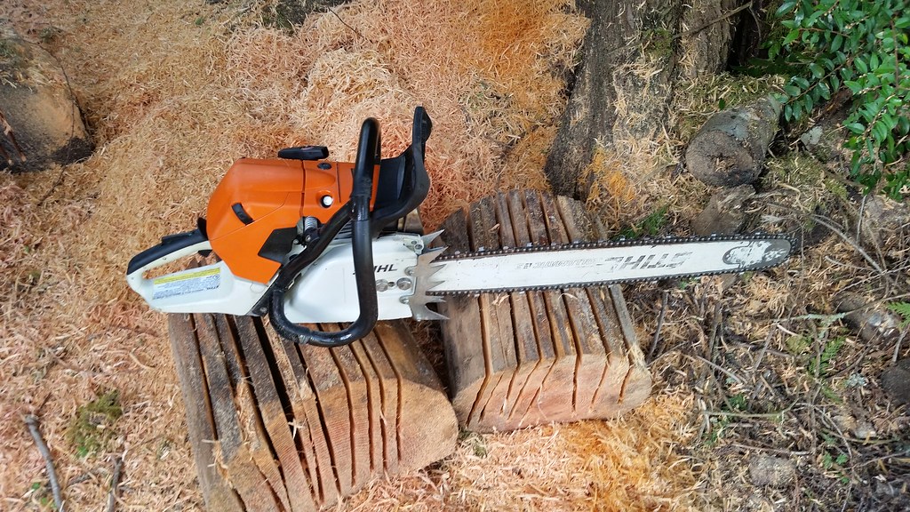

Got some time to run it today for a while. Bucked up a bunch of 18-22" rounds then went about noodling up some new bedding for the chicken coop. I'd run it for a bit, let it idle 5 or so minutes, run some more, shut off, start back up, idle, run, etc. Not a single hiccup with the Mtronic after a tank through it. This thing sips the fuel too.. My 036 would have used two tanks for what this cut today.
Pulled the muff after all the work was done, P&C looking great.
