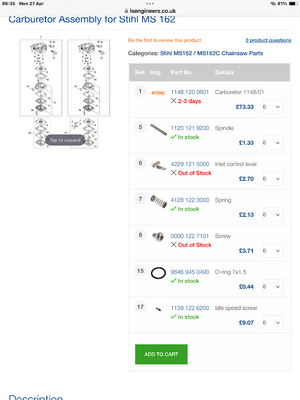

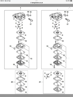

jmester
3:22 PM
1769
Aug 28, 2016
1,266
3,727
VIRGINIA
#3 part number
1130 121 5601
Fixed jet 0.44
For these carbs
  • 1148 120 0601
    Carburetor 1148/01
  • 1148 120 0603
    Carburetor 1148/03
