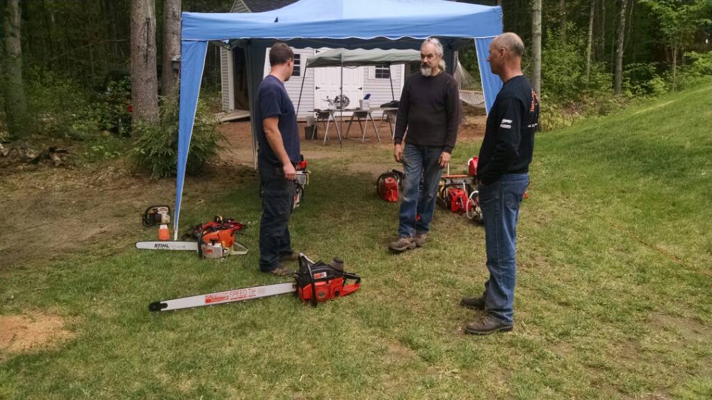

The four of us had a great time. We all got to run what ever
we had there. Those ported Stihls were pretty impressive. And
the Dyno is a work of art.
Thanks to everyone.

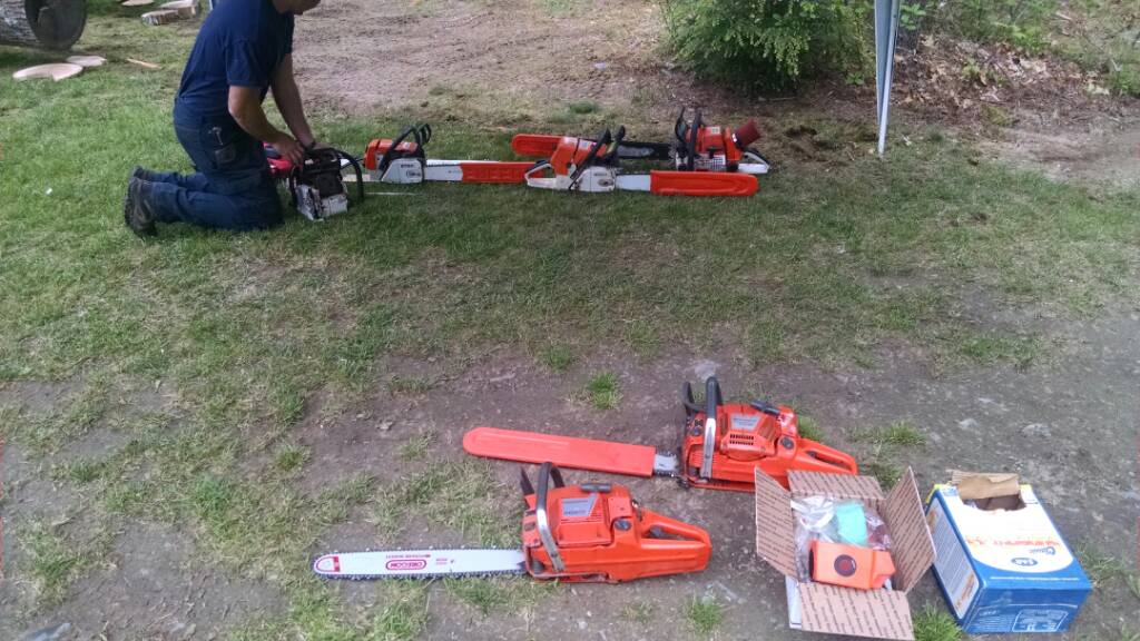

The first video in this post is the 166 with the 084 piston. Stock 166 cylinder
was bored out 4mm. Went from 56mm to 60mm and now 136cc's.
Best sounding saw today. When it pops you hear it echo off all of the trees in the town forest that surrounds my house.
