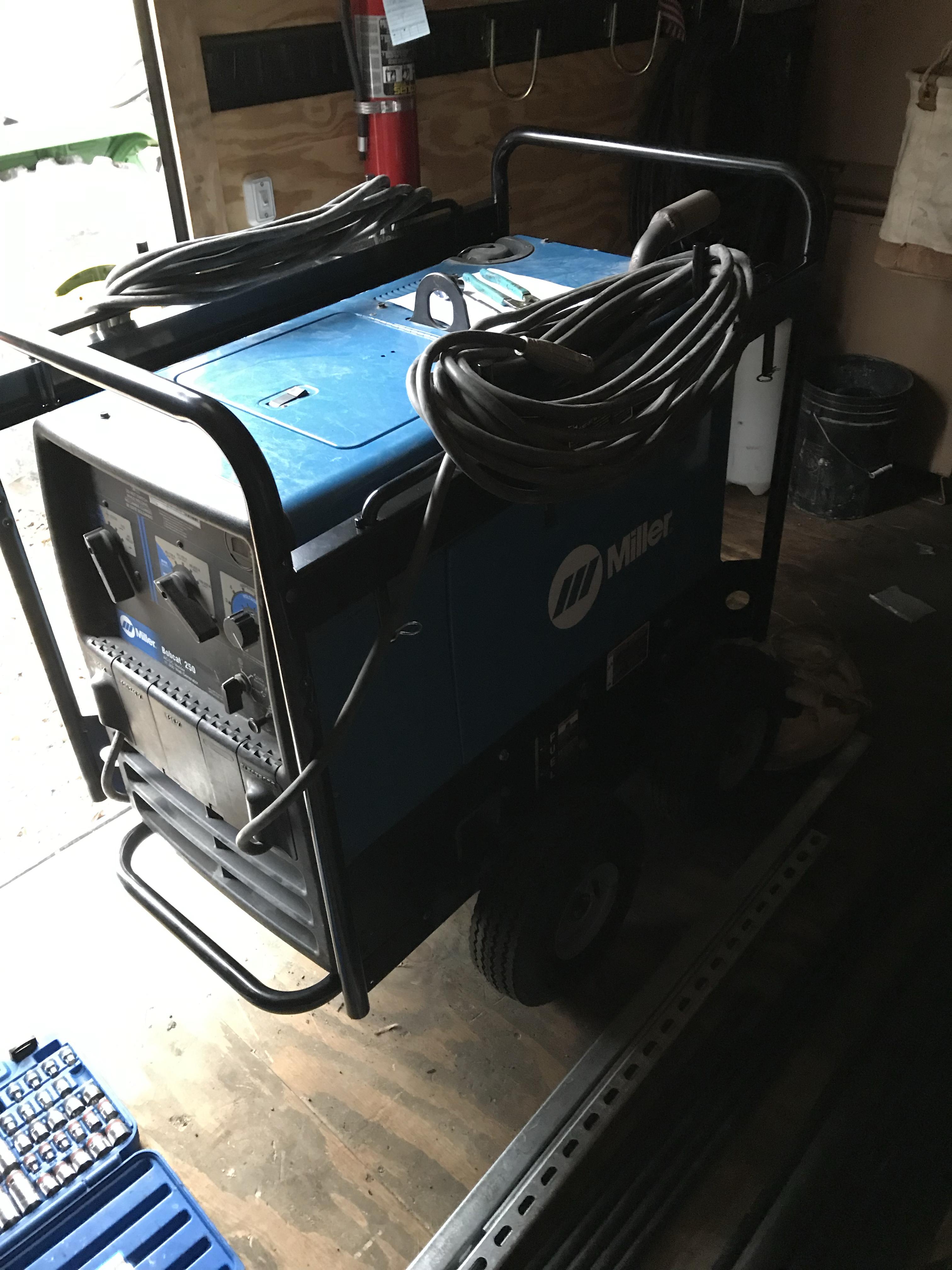

Do any of you have experience converting gas engines over to propane?
I have a low hour Bobcat 250 welder/generator that im considering converting. I want to use propane because of the ability to store bulk fuel without having to worry about it going bad. I use this for work and as a backup generator at the house.
So bulk fuel storage stability is the upside, the downside is ive read here that propane is bad on engine seals. Also I read somewhere if you convert them then you can not go back to gas because the engines wont last? The last statement doesn’t make sense to me except maybe the seal thing.
I know that Miller makes a propane version of my welder but dont see where they sell a conversion. Any information on longevity and who would make a conversion kit would be appreciated.
This is a 2014 with the Kohler engine.
