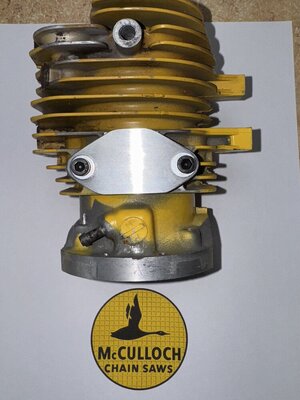

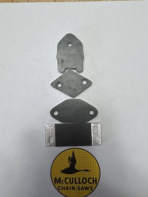

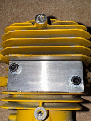

Was wondering if there is anywhere to buy/ idea to make a block off plate for the exhaust and carb to get a vacuum pressure tests similar to my Stihl tools that block off the intake and exhaust. I have read a few things in the Mac threads about people making them. Was wondering if anyone sells them / guidance on making one. For a PM850, PM700 and PM 10-10s that I want to keep running forever. I also just like to collect tools I might use once a year 🤣

Check with member cinci5 here on OPE. He was making and selling them on eBay but does not have them listed currently.
Alternative is to cut a solid "gasket" from rubber (inner tube, etc.) and use the muffler and carburetor to seal the openings.

It'll be in June because I'm away from my mill but have other products with me for eBay. I'll make a few sets and re-list them.

The Echo service tool rubber block off plates are not model specific and cheap to buy, like 10 bux. I've never found a 2 cycle engine I couldn't use them on.
