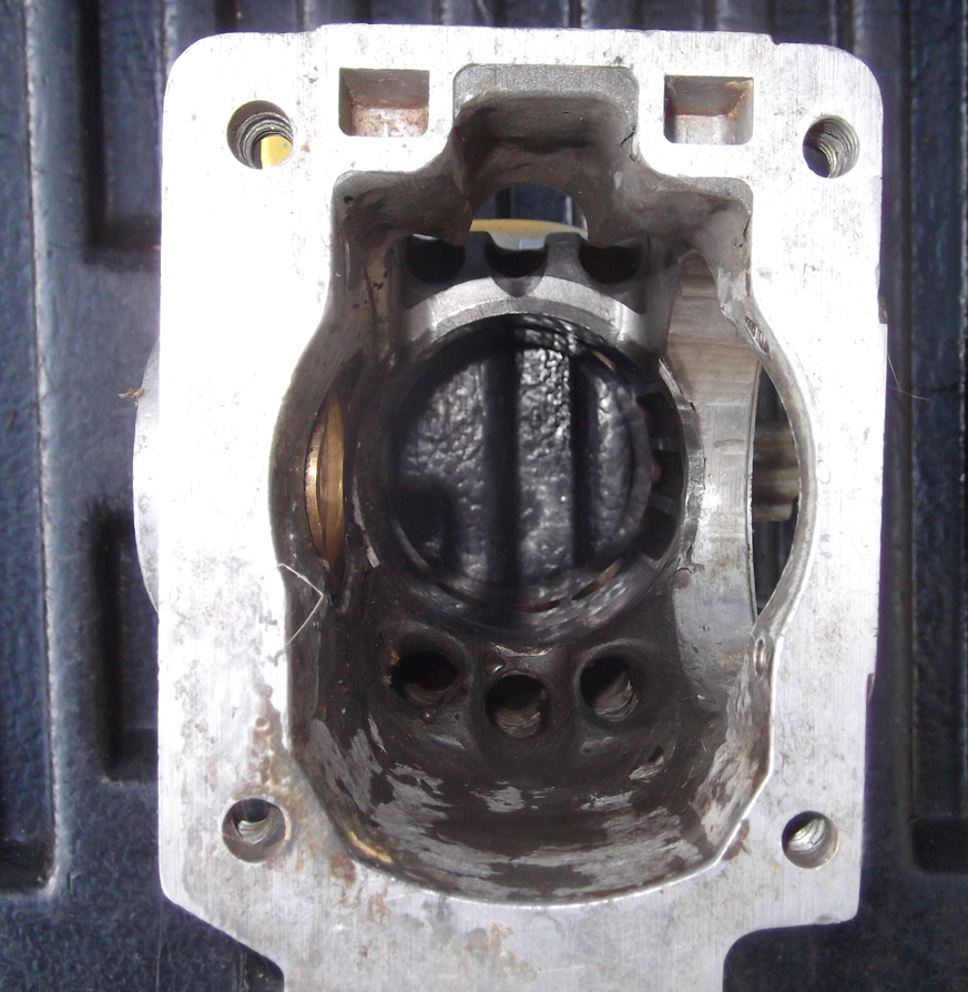

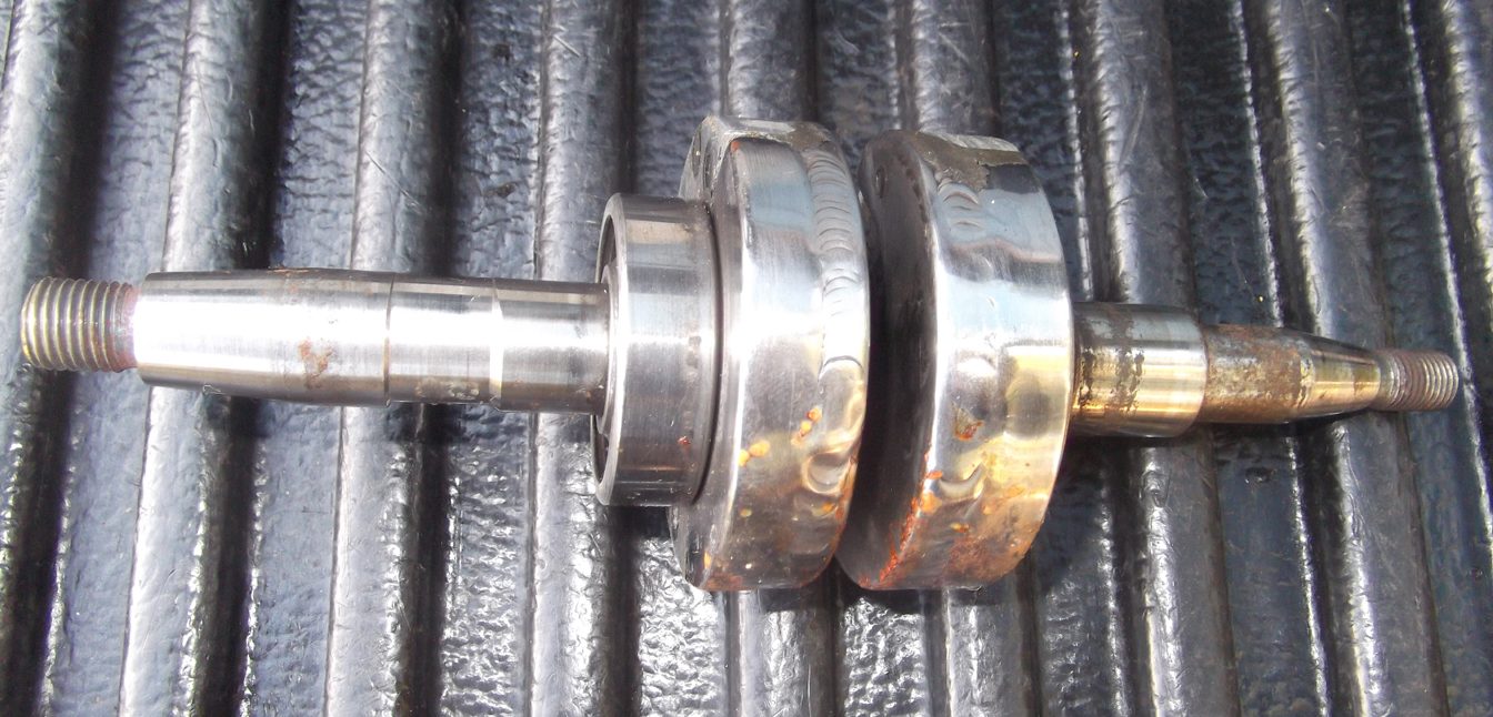

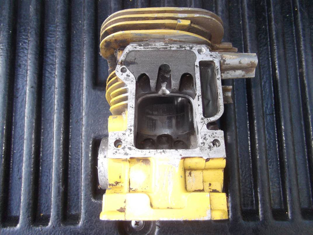

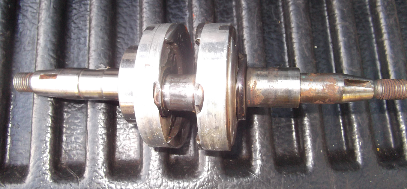

Nathan - I hope you're ok with me piggy-backing on your thread, but I wanted to post some interesting pictures of some kart stuff I got from a machinist years ago in Michigan.
It's an MC-6 engine, which he ran in the vintage class, 87cc. He made a full-circle crank, and it's a fully-welded, all metal full circle crank. I've not seen anything like this in any
Mac engine I've ever torn down -
jacob j.
Only the weird
10:02 PM
232
9,790
67,276
Coastal Oregon

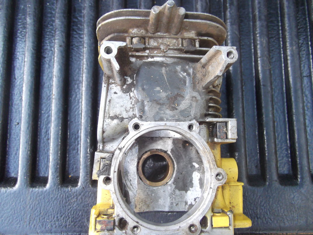

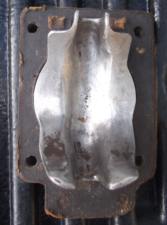

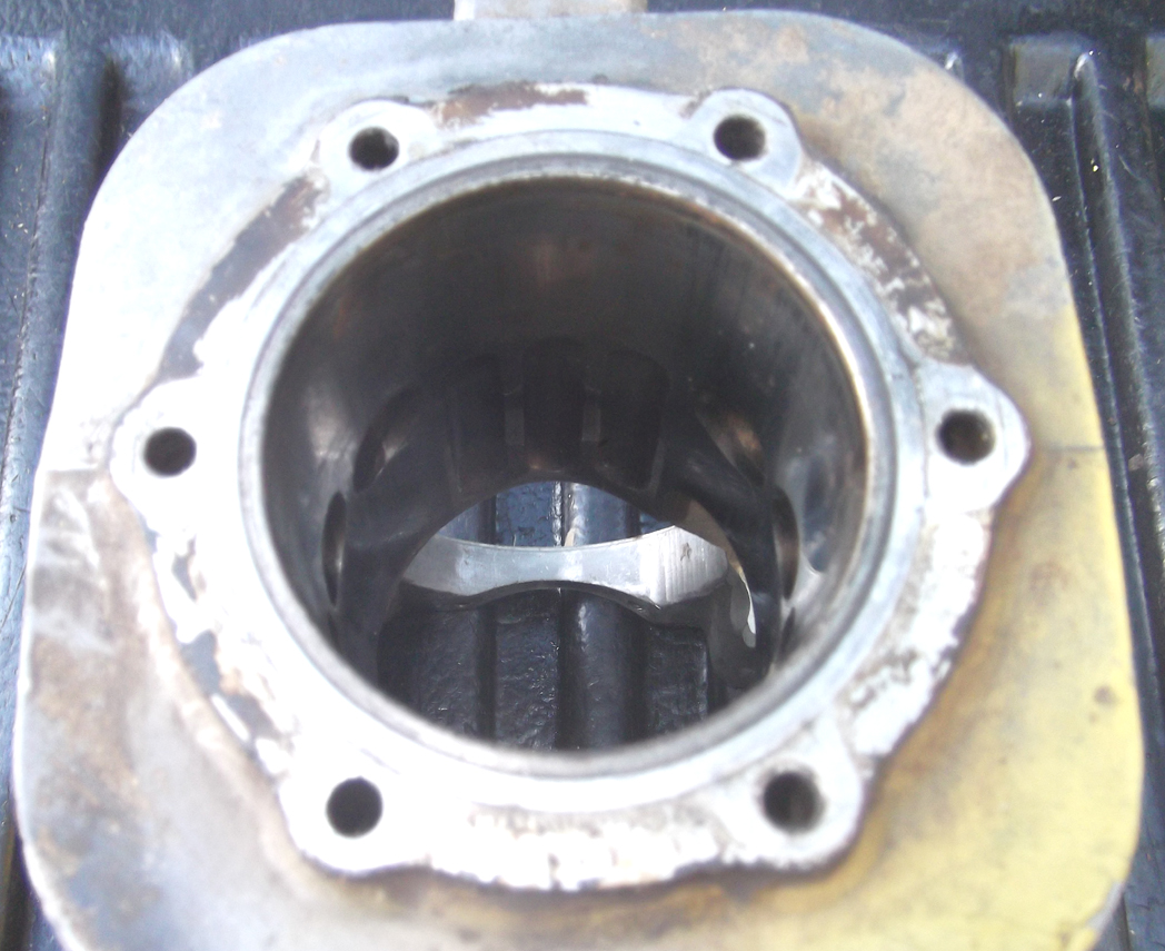

The block is where it really gets interesting - he filled a large part of the intake, all of the ninth port, and the rear transfer tunnels with Devcon.
He ran a BDC carb on methanol (on the sloper style intake manifold) through this engine and he said it was the fastest 87cc engine ever.

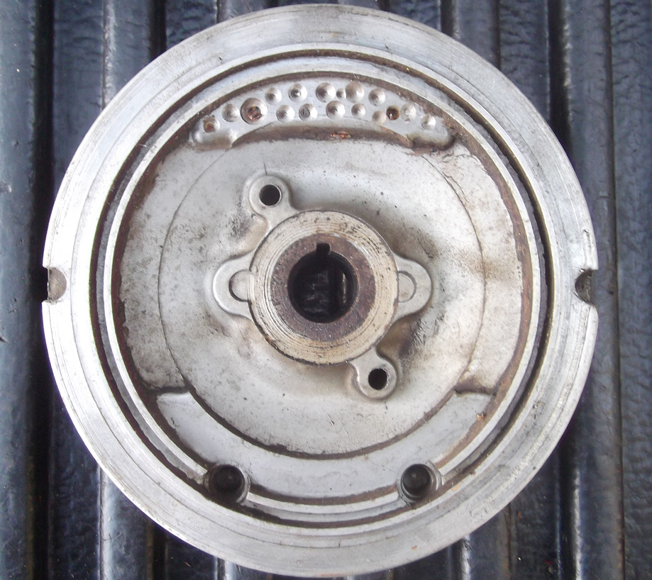

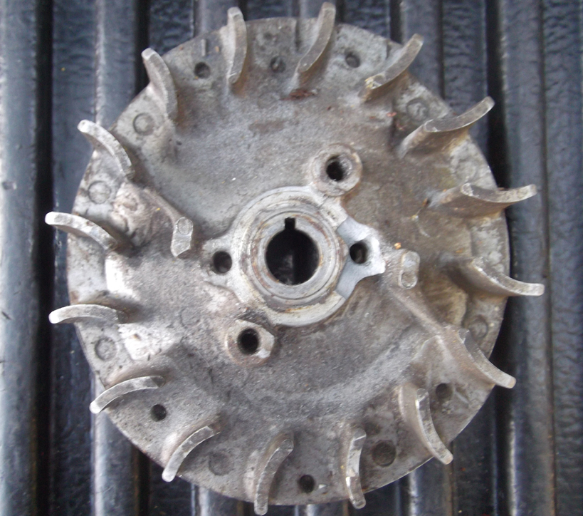

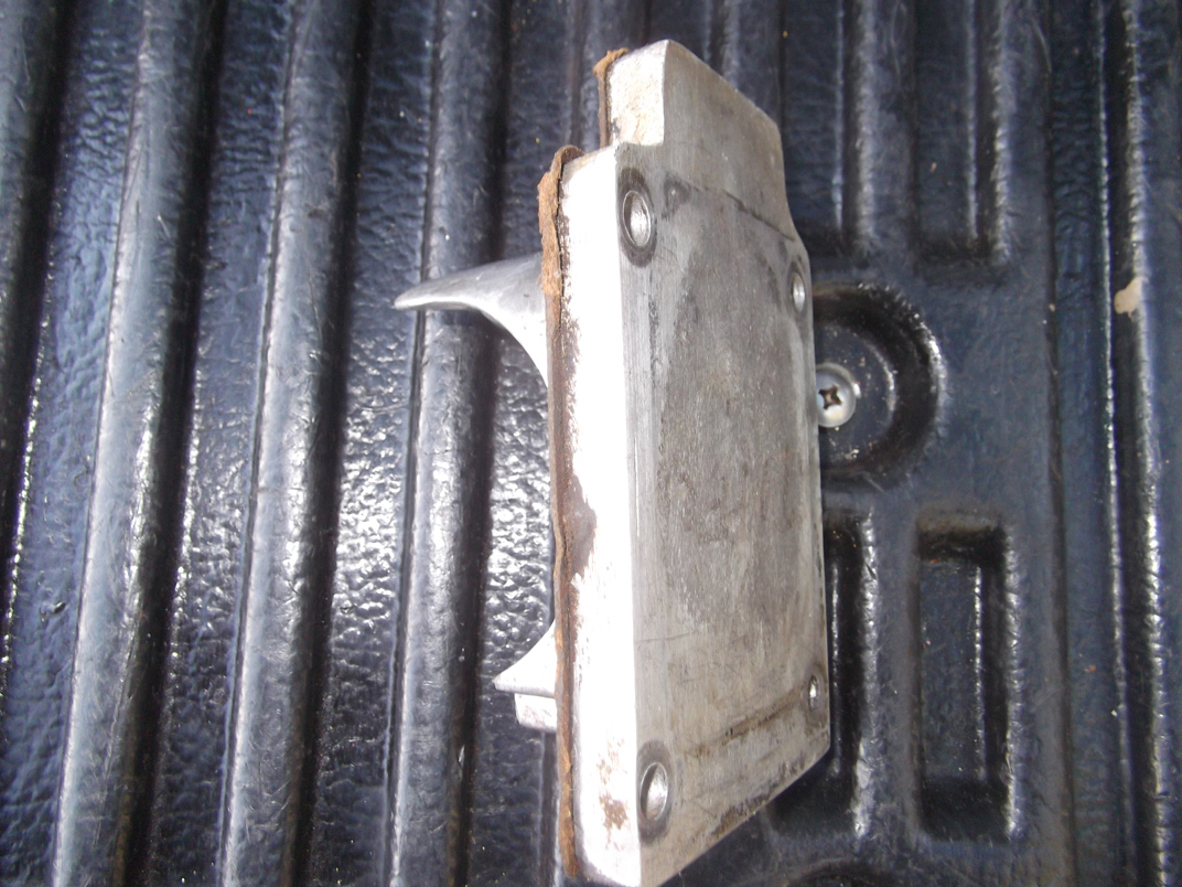

Even the flywheel is trick - the fins have been machined down about 3/8", and the back was shaved significantly. It's also been balanced - in the top of the first picture, you see where he drilled the
casting during balancing. In the second picture, you can see a broken area near the right center of the flywheel - he had a starter cup mounted there that broke off when he crashed his kart. This
flywheel weighs almost half of what a stock flywheel weighs.
