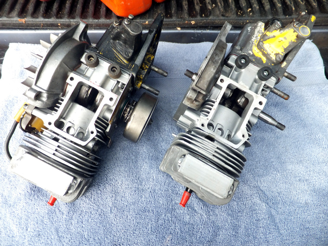

Looks good! I like you av linters! You should do a write up on that!
Mmmmm Yummy, Are your decomps in different locations. I to like the AV limiters
Thanks guys - yeah they're Stihl 066 case buffers. I don't have any of the regular buffers that came on the 125 cylinders, so I used these and mounted them with lock-nuts and Blue Loctite.
The heads are interesting for sure - I got them years ago from a kart guy that had already modified them and he was hand-starting his motors.
Now that Nathan has discovered the variation in timing on some of the flywheels, I'll have to check mine over real good and look for some that have the better timing.
