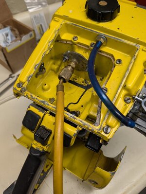

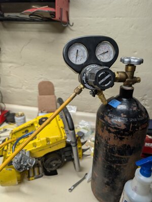

Well I took a little brake from the 797 as I was a little frustrated. When I would set up the hand pump pressure gauge, it wouldn't even move the needle. I was at work the other day and it dawned on me that I have everything I need in the work van to keep a constant supply of air so that I can leak test. Tapped my blanking plate to accept a new fitting and was able to hook up my Nitrogen. The Decomp port is definitely the main problem. I'm going to get some valve grinding compound, but I think I'm going to end up having to plug the Decomp.1000003280.jpg1000003279.jpg
