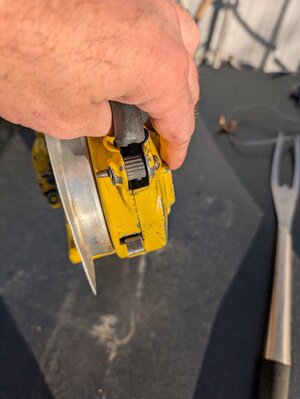

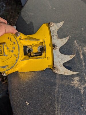

Here is some pictures of the P/C. After a weekend of looking the IPL's of the early 797, S797, CP125, and 101 kart engines, I want to verify that I'm reading them correctly. It appears the simplest solution would be to find the proper oversize piston and put it back to stock. My question is for you all that have ran 123cc saws. Would it be worth milling out the boost ports, finding a windowed piston with corresponding rod, wristpin and boost cover? Is that all that would be needed to make it like a regular 797? Jeff View attachment 472786View attachment 472788View attachment 472789
It definitely doesn’t hurt, it’s not a massive gain. I had terry do it to a cp block, but did a lot of other work to it so it wasn’t the only mod.

I may have a new std piston, But before you put a std piston back in i would mic the bore and make sure it is round. I bet it isn't anymore and in that case boring the cylinder to the next over size would be recommended. I will also look to see what i have in over size pistons.

Bigmac - thanks for the info, I talked to Terry today about having some machine work done.
Mark - Thanks for looking, those two could be an option depending on how the cylinder turns out. Are those window pistons by chance?
Lee H. - Thanks for the welcome. I believe the cylinder is in need of boring due to the piston damage. I'm not kidding you that I have read over 200 pages this past weekend. I probably ought not have read the SP125/101 threads lol. You have some very nice builds. I read a lot of your and JJ's threads, very cool and helpful.
I'm thinking I want to open the boost port window, and find a regular 797 or kart window piston. I'm digging through IPL's trying to make sense of the 101 variation pistons. Terry did say that you could drill two holes in a S797/CP125 piston for the same effect though. Does anyone have a boost port cover they might would part with?
