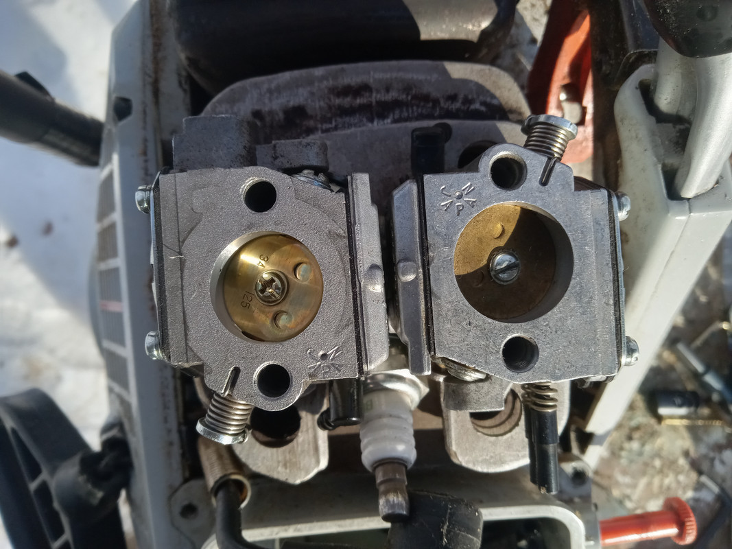

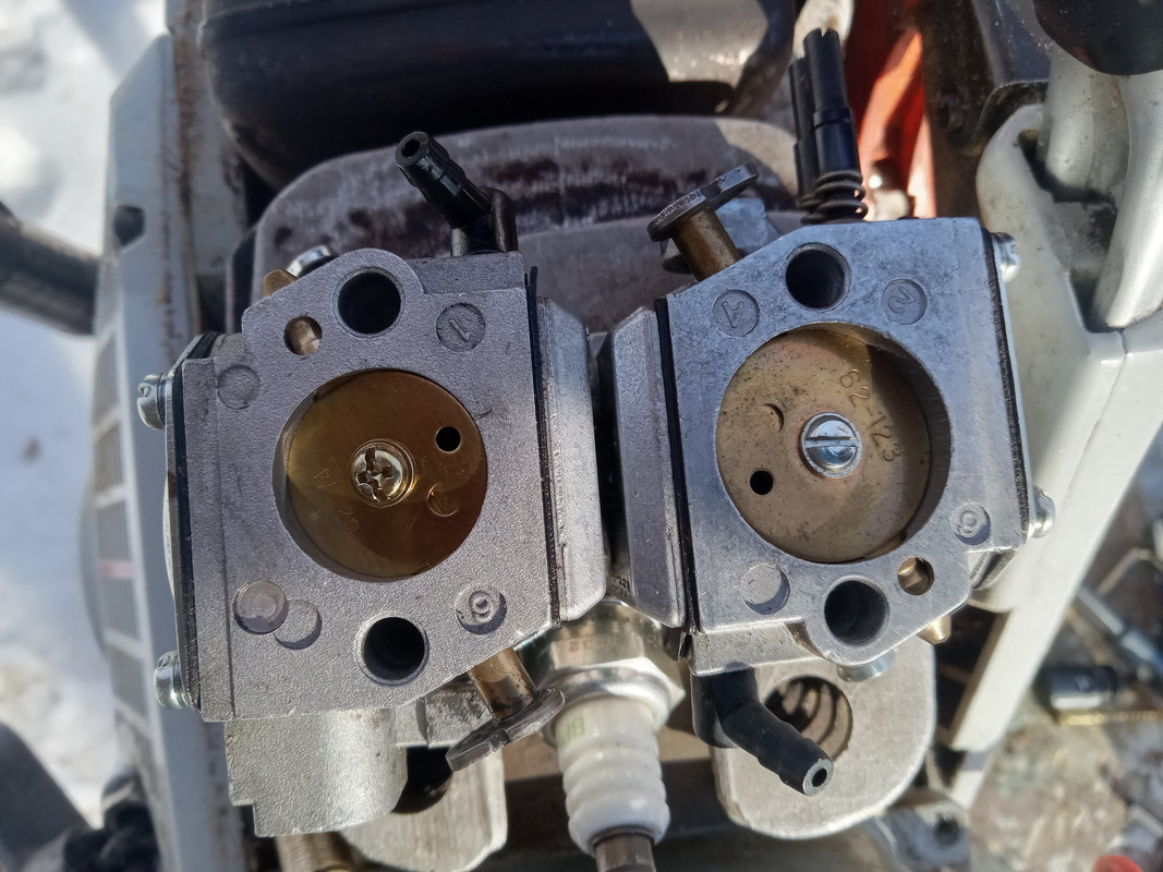

Thread ain't dead yet. Here it is many years later, and the undersized carb on some of the 8000's and 800p is still a problem. 4-5 turns out on high jet, I could not get my ported 8000 blubbering rich. Surprised the high speed jet didn't fall out the darn thing.
It was very discouraging, after many hours of porting and cleaning the saw. Felt like a waste of port work: run saw hard in a dozen cuts, then it shows lean on the plug after saw gets up to temp.
153b carb is insufficient after mild port work. The newer choke-engaged high-idle carb is the same deal on the 800p, too small.
Part # 12300030830 is the HDA 45 carb and it is substantially better. Like blubbering rich 2.5 turns out on the high jet. The HDA 45 is from the old echo 8000p. Might be pretty easy to retro-fit the throttle lock from a cs 8000, onto the 800p, if using the hda 45? I dunno, they sure look the same.
153b vs hda 45 choke bores
153b vs hda 45 throttle bores
