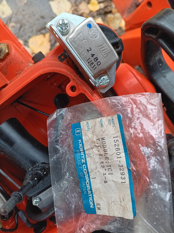

OK, just got in my man purse of 1201 parts. Looks like Pav chucked an empty bag and the original module? Maybe that empty bag is the unlimited kapowpow?
Also in there was the original spur sprocket he replaced with a rim sprocket.

I sent Paveen a message. Thanks for the help.
No problem. She sounds zippy now. But then it settles into that infamous low end grunt, exactly where a milling saw should. Where she settles into buried 42" bar territory, the carb feeds just fine.
2 years of grins and slabs later, the 1201 is just broken in. They're built to last.
