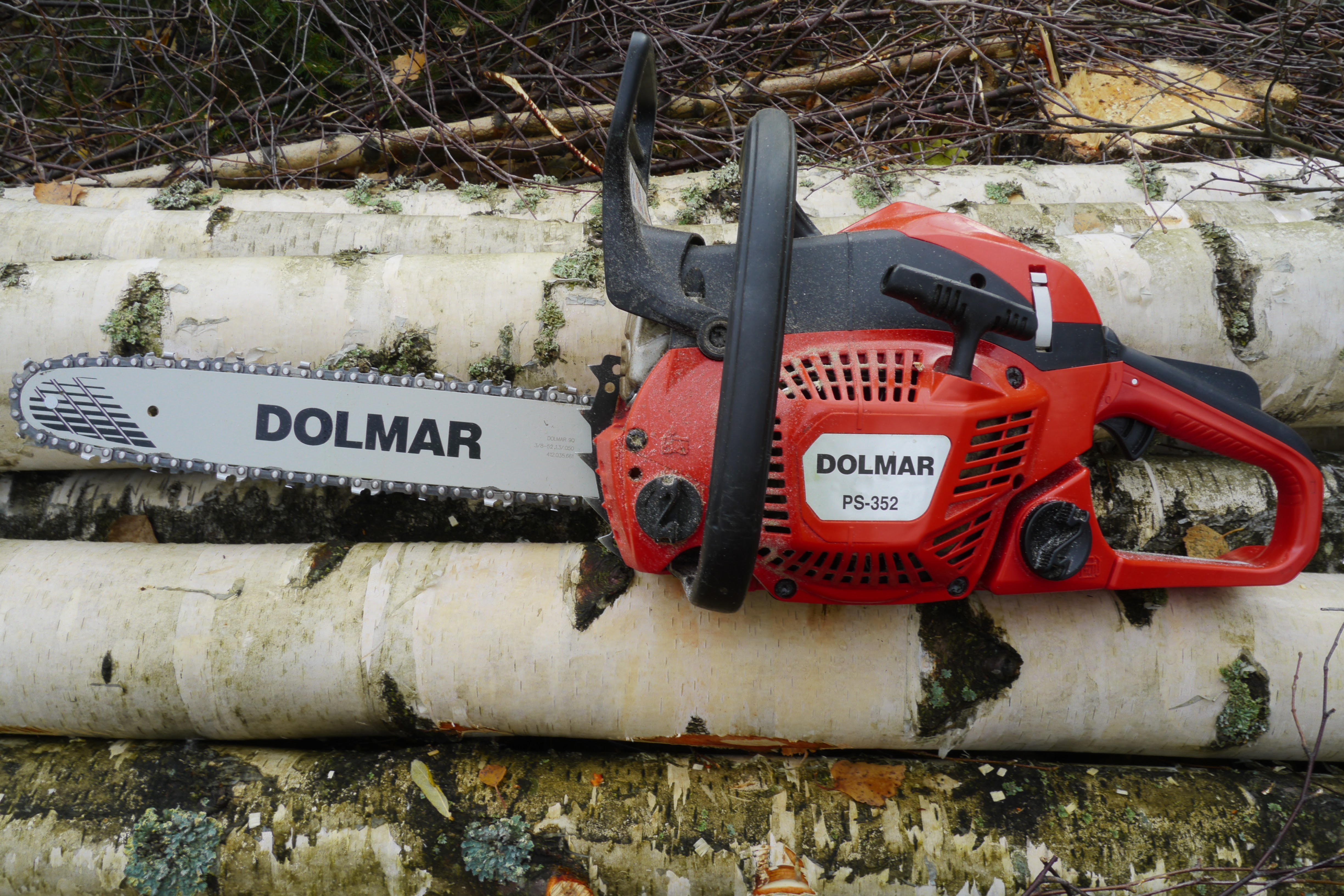

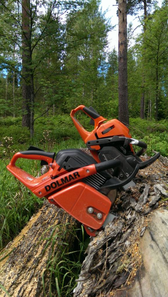

The rear handle is similar that in my 6100, it feels good in hand because of its curvy profile. It's also slightly higher than on husky 560 (see picture), giving better control when tilting the saw. The rubbery grip that the Makita battery saw has is my favourite, because it reduces the power needed to grip the handle firmly. Ps-352 has has a texrured surface casted in the handle, I find it rather uneffective.

I have compared the battery saw mainly against the new Dolmar ps-352 that produces 1,7kw, it isn't a fair game since the maximum power of the battery saw is 1,1kw. They also use different chains, battery saw has 1,1mm wide and the petrol saw 1,3mm. The ps-352 has a lot of grunt for it's size, and light weight.
