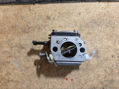

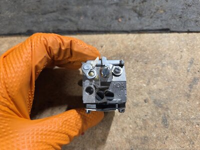

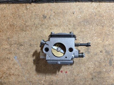

On the right is the hda-144 on the right is the hda-212. The port for the impulse lines up right. I just had to swap the choke rod and the plate went on fine. The 212 is a bit taller but it doesn't seem like it's gonna interfere with anything?IMG_20190211_144131020.jpg IMG_20190211_144105243.jpg IMG_20190211_144052044.jpg IMG_20190211_144131020.jpg IMG_20190211_143916150.jpg

The big question as to whether it's worth swapping is what's the size of the venturi and throttle plate on the 212.
