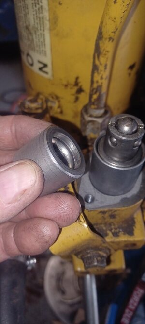

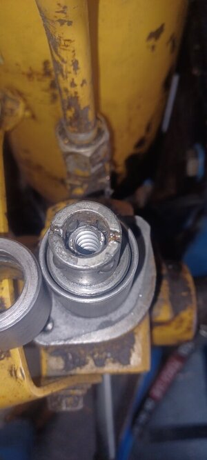

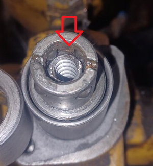

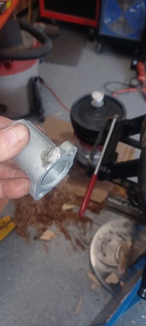

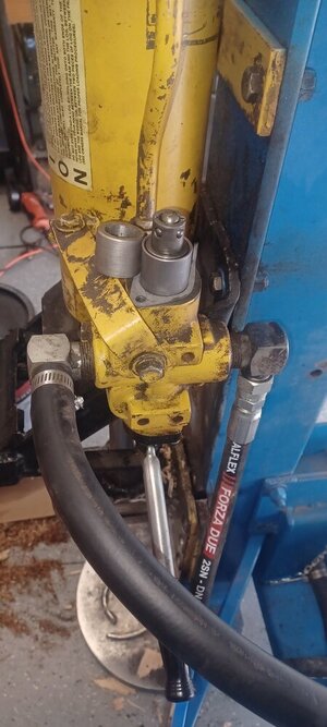

so, I had to remove and weld the valve cap on my old splitter the other day and managed to pop the spring loaded portion...oops.
At least I found all the ball bearings and spring :p
but, now I can't get it all back together. I believe that center ball needs to be below the smaller ones when the top ring is in place. There is a small spring just under the ball. I'm also not sure which way that top collar goes, note the groove on one end that the smaller balls rides. I have tried installing the cap and pulling up on the lever...no joy.
suggestions?

I have never worked on one of these before, do the four small bearings come out or are they kind of pressed into place?
If they come out, I would imagine that you have the spring in there, push it down with the large bearing and then put the four small bearings in. When it comes to the top collar, if you put the small bearing groove towards the top, would the way the collar sit, allow for the small bearings to expand out (into the groove) or are the two mismatched?

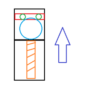

Not sure if this crayon drawing will help with what I am thinking:
1776893359790.png I am guessing that the spring (orange) pushes up on the large bearing (blue) which causes the four small bearings (green) to then push out into the collar groove. When the pressure is relieved, the spring settles back, causing the four green balls to push back and cause the blue ball to recede back.
Again...this is a guess on my part.

Correct. That is my understanding of the mechanism

Ok, I found some instructions if the detent is too low or to high, not sure if either of the steps (if there are specific steps) will help:

Since you had parts flying all over, maybe the detent valve replacement instructions might be helpful:

I get that, I just wasn't sure if there was something in the adjustment process that would re-prime that setup or re-align something...
Ah, I wonder if that's how you have to get it back together...good question.
I was hoping somebody here had worked on one of these who would know.

I did a little more looking on YouTube and found a video that probably goes into more detail about working on the valve than what you are looking for, but it shows the tear down and rebuild step by step. The guy has a pretty good idea when it comes to putting in the large ball bearing and the collar. Hopefully this video helps!
On yours, it is looking a little grimy inside with the bearings and the spring, hard to tell from the picture if it is just dirty or greasy, if a little dry, may stand to use some more grease.

Not certain if it's just lighting or grease.. or just my danged eyesight again.
The groove that the 4 smaller balls ride in, is the groove worn in a bit deeper than factory spec?
Might just be grease hanging on the edges of the groove?
If the groove is worn, seems like the big ball might "settle" a bit out of place at some point of operation.
If the big ball is a little offset in its travel range, what happens to the flow and controllablity of things?
Just found this, lol.
Procedure at the end of the vid 😃
Won’t even need to remove the valve from the splitter…

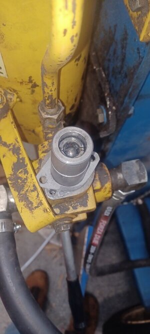

It worked 😃
Well, it worked after I turned the top 'ball holder' the right way. (Pictured the wrong way)
Put it together and it worked...opposite of what it should, oops.
Take apart...more carefully this time, flip, reassemble and voila!
The auto return works better without a broken cap. :p
