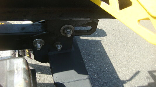

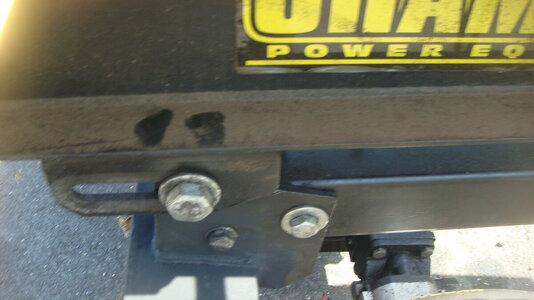

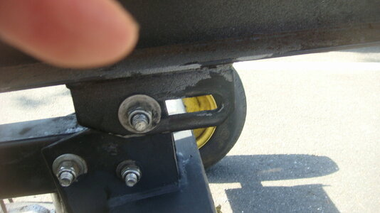

The local "forge" said that the engine had to be removed before he could work on the log splitter. He has some logs on his property he wants split. In my experience it is very hard to adequately trade or barter on one thing for another or one job for another. What do you think? I don't have room to work on this myself.

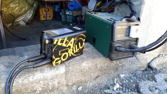

Make sure it is an inverter welder though!
My first flux core wire welder purchase was a bust, a transformer welder with no electronics to "help the unskilled user smooth out operator errors".
Years later I dared buy another, this time a digital inverter welder.
It has one On/Off switch and one knob to set "intended workpiece material thickness" - the welder determines and supplies amperage and wire feed automatically.
Also, hobby inverter stick welders have become just as affordable yet powerful and in my experience lay a deeper wider weld than hobby flux core wire welders.
My tiny Gorilla got me hooked to welding.
I sometimes take two scrap steel pieces and weld them onto each other simply because I crave the sound of laying a bead.
My stick & flux core wire welders.

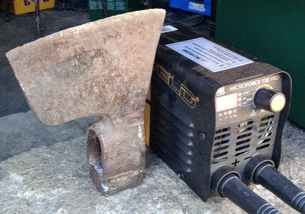

The size of the Gorilla stick welder

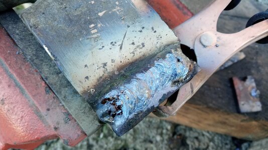

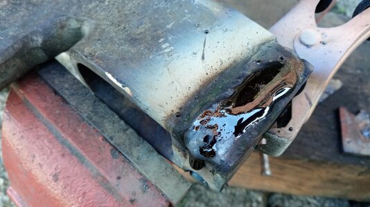

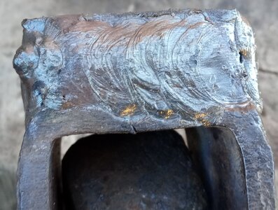

The bead the Gorilla manages to lay on every pass, Amps maxed out & available features enabled, with a 3.25mm (~1/8") 40+ year old basic coated Oerlikon Spezial electrode.

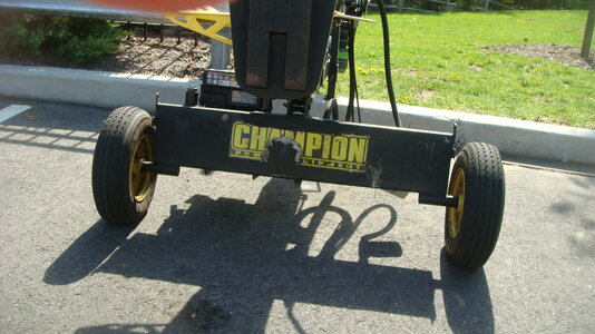

I called my local welding company, forge, no response, he said he'd be available today last week but no such luck. I drove to where "AC Skips" welding was in Norwalk and was shocked he had a heart attack a few years ago.
So the gentleman who is now working in his former shop garage gave me a good price on fixing the splitter.
Champion would want around $350, $200 for the hydraulic tank and $150 to ship it FedEx ground. So welding makes sense.
