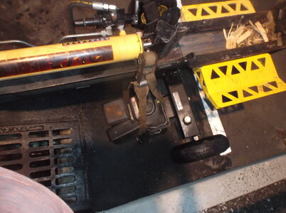

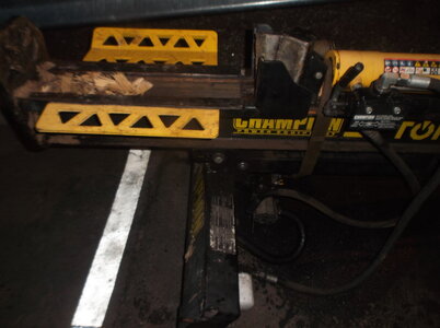

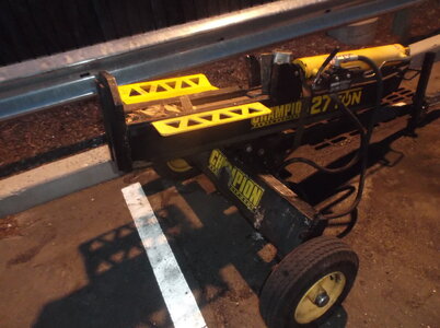

I posted on this log splitter with the sagging engine that became critical. I trussed it up so I can drive this to a welder. I bought a bunch of welding angle iron and plates. For the welders out there how would you do this one?
I picked up:
8x24 inch 16 gauge weldable sheet;
3/16 x1 1/4 flat sheet;
1/2 inch rod
angle iron: 1/8 x 3/4 x 3 ft
1/8 x 1 inch x 3 ft
flat 1/8 x 1 1/4 x 3 ft flat

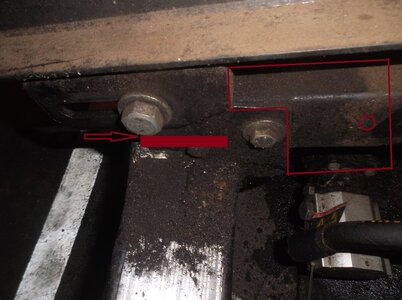

I would just take the two parts off, clean them and tig weld, grind the back side smooth so it doesn't hit and re-install.

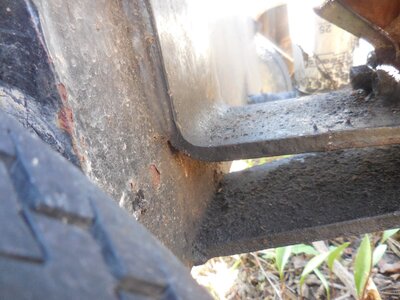

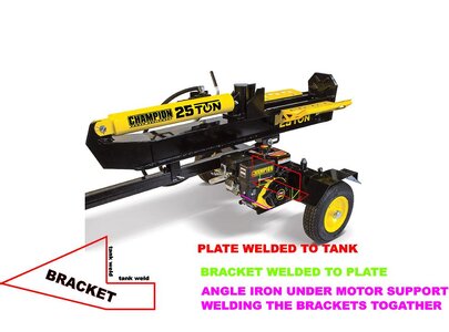

The brackets on each side of the tongue to hydraulic oil tank are definitely inadequate. First, if there's any space between the top of tongue and the reservoir then it should have a steel pad (shown in picture) tacked in so the bottom of tongue is tight to the reservoir. Besides prepping and welding up the broken area, I'd also add a piece of plate (shown in picture) to extend the existing so that you can place an additional bolt through the tongue. The motor weight is a big lever so adding more surface area will help. Make sure to properly chamfer and prep material and weld it up. Do both sides and you should have a splitter that will give you many more years of split wood.

If the existing tank isn't compromised, you can just weld whatever fix necessary to it. You could cut the brackets off completely and weld on new and improved ones.
If you do end up buying a new tank, I'd still add a gusset where needed because the new one will have the same weak area as the old one.
