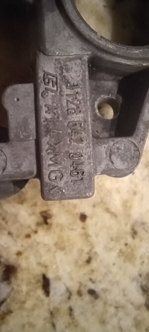

View attachment 482163View attachment 482164
Yes, that type. Quick question though, I see some Stihl markings on the one oiler but mine has no marking whatsoever. Would an OEM oiler always have markings to indicate that it is OEM? If mine is aftermarket I'll just replace it with OEM and move on.
I believe there should be an 1128 number on it if it’s oem

Well shee-it, guess I'm buying a new pump. I kinda' figgered there should be some number or at least a Stihl "S" logo.
Might be a catch to matching it up. Book says my 044 ends with 3205 but I see other numbers for it.
Oe Stihl parts have pt#s
