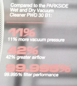

Workshop vacuum cleaner 7 layer HEPA filter bag over the saws stock filter? 🤔
It supposedly functions through deflection of particles, not restriction of flow.
I would have to read the info leaflet of the filter bag package.
