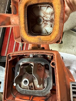

Hi top 288 (thanks @Stump Shot) seems like a much better filter than the plastic filters.
I suspect I should get larger PC Racing filter skins for it though if I want to catch most of the dirt. This seems to be stretched to holy. @MG2186
Ok to oil husky flocked filters or no? What is the flocking made of? Paper or plastic?
Thanks

No on oil and you can get an outerwears cover to fit that filter.
If I recall correctly the one for the 661 will do.
