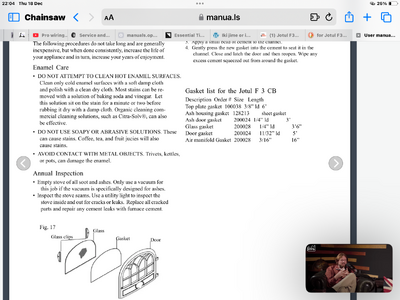

I think it’s a broken clip as well. I googled your model (although I don’t know what I,m looking at) and came up with this screenshot. There are a few ipl's
I guess as a short term solution could be just a fat wad of fire rope wedged underneath on that that ledge to stop it droping.

I concurr with the broken bolt, missing bracket theory
