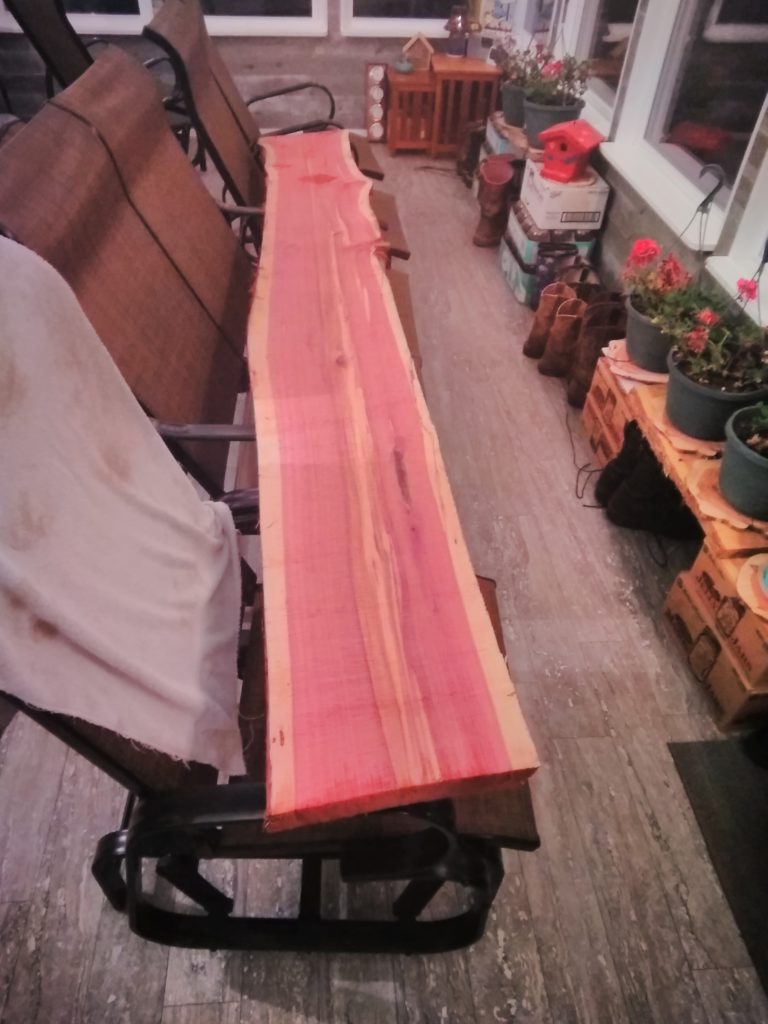

So I did a little cutting today, cut some 22" red cedar cookies, tuned it in the cut a bit fat. Cut like a hot knife through butter. A 24" bar on this saw is really ridiculous. So after I got done playing with the cedar logs at the bottom of the hill. I put the 36" bar and chain on, and put it in my 48" Alaskan mill. Slabbed off 3" and removed the ladder. Re-adjusted the mill for 1-1/2" and made my first live edge slab. I took it easy and would go a couple feet, let it idle, etc. This is only a 15" log. Chain lubing fine. Started to rain, so I went in my building to wait it out.
Re-filled the oil and gas, and the saw would not turn over. Seems the dogs are now clogged with wet cedar dust, and stay retracted. Wiped down the saw, and took it out of the mill. Cleaned out the dust and now it is fine. Called it a day as I had other things that needed to get done. I am on call this week, so I won't get a chance to play. I know, pics or it didn't happen. Not sure how to do that. Do they need to be hosted somewhere and link them?

Beautiful!
Thank you. If I keep this up, my wife may want me to get a Band saw mill. One can dream right?
I have a bunch of large cedar logs to practice on, then I have a 32" White oak that will get milled too. Will need longer than the current 36" B/C.
