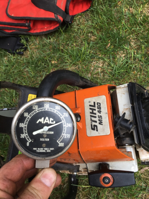

Have you checked compression?
I'm curious what it is at your elevation.
Hopefully it's under 225
