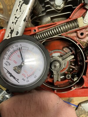

Update. I ran 7-8 tanks through the saw and all was well. Until it suddenly went way lean. Figured my seal fix went kaput. Today I finally got around to pressure testing it.
Here’s the video.
Leaking the opposite side of the fix.
Here’s the video.
Using epoxy to prevent an air leak is never a good idea.
But what’s funny is it’s the opposite side as the epoxy. The side with the repair isn’t leaking at all. Is it a bad seal? Is it ever so slightly out of round that it pancaked the top side. Is the seal pinched funny when pressing in?
I feel like further investigation is required and hoped for some ideas.
Also the leak is slow. Barely nicking a psi every few seconds. Can anyone elaborate how much of a leak is needed to obviously know a running saw is leaning out. I saw this because I’m thinking there’s something else going on here.
If I can see the needle move looking at it for 5 seconds, I try and fix it. In my experience, leaks that cause running issues are noticeable on the needle. They usually only pump up to less than 5 psi and will fall off quickly to under 2 psi within a few seconds.
I would put yours under vacuum and let it suck some Motoseal or Loctite into it. And then let the pressure off and let it sit for a couple days

So I added some motoseal to the opposite side of the jb epoxy fix. Pulled vacuum for 5 minutes or so then just pumped it every 5 minutes or so. After an hour I can back and checked it and it was holding vacuum.
Tomorrow I’ll clean up the excess motoseal and throw some pressure at it and see how she holds.
I fixed an 066 for @jacob j. like that. I don’t see any reason it won’t last
I seem to recall using 1159 sealant upon installing a seal on a firewood saw years ago that had a defect in the case and it did the trick, still chugging along a decade later.

Should be fine now. My 350 was leaking like a sieve after 3 rebuilds. I couldn't get it sealed up. Finally just bought another case and that fixed it. Must have been warped just right so it would leak even when slobbered in sealer.
Don't worry about the jb weld. It'll be there for a LONG time. I use it in my lower transfers to increase flow. It works wonders.
