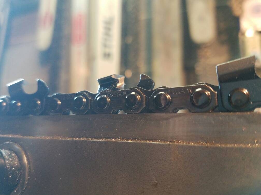

I love a new file. Bottom picture is a new tooth. 2 swipes.

Can you post a pic of how you are holding the file? Still doesn't look right. There needs to be a defined line left from the corner of the file (black line). This is the line where the angle changes on the file. So from the left of the line is where the wide flat part of the double bevel is touching the cutter and to the left of the black line is where the smaller edge touches.

i was just about to make a line on a pic like that too.. gotta tuck the file under yr chin and in a downward motion; it looks like you are going more across the tooth.. use the edge to line it up like in the pic above. then start filing. HTH

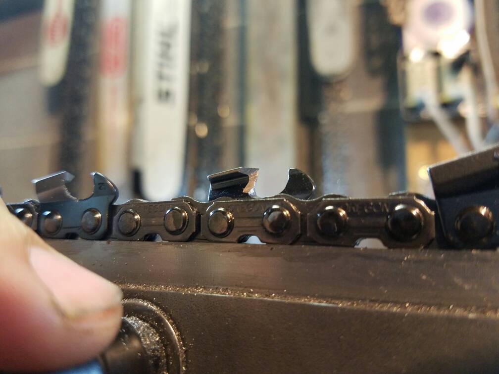

The line is there The Flash is hiding it I'm still a little bit low I think it's also my consistency I'm holding the file getting the line straight down that point but I think it's getting better I'll try to get better pictures

BTW he makes that look SOOO much easier than it is in my hands....

That he does. The vid shows the basic technique. Not really the presice zoomed into, this is where the edge of the file goes, but it gives a good idea as to the angle of how it's supposed to flow.
He had two up, but the other disappeared.
