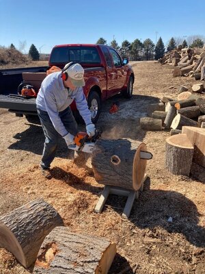

Hey i like that contraption uve built for noodling wood ! I might have to make one my self ! Have u got any more photos ?
Here's one:
This ash round on top the white supports I made is about 27" dia. I still use them after 10 years if I can only remember to bring them with me. I roll the round log onto the supports for halving and quartering primarily because I cannot lift a round hardwood log this big onto my tailgate and never could. I also keep a wedge in my back pocket for dividing the halves and avoiding pinch. The really big ones I quarter and sometimes cut into sixths.
