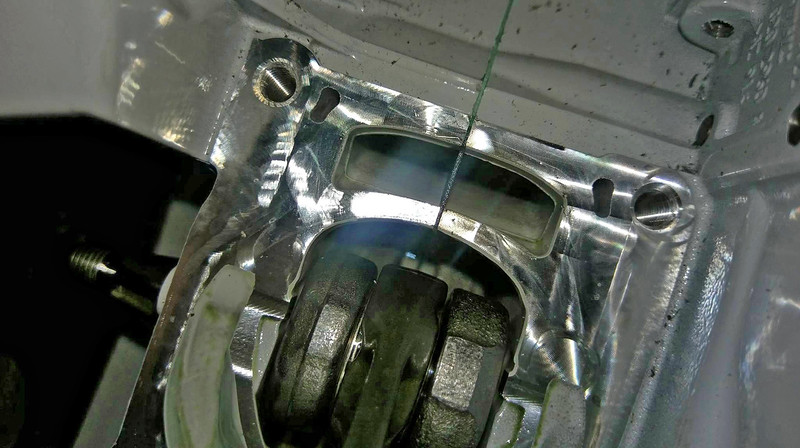

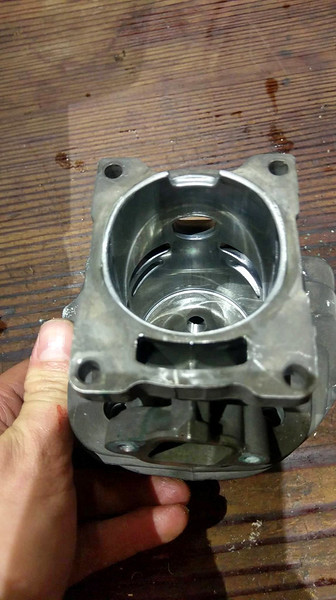

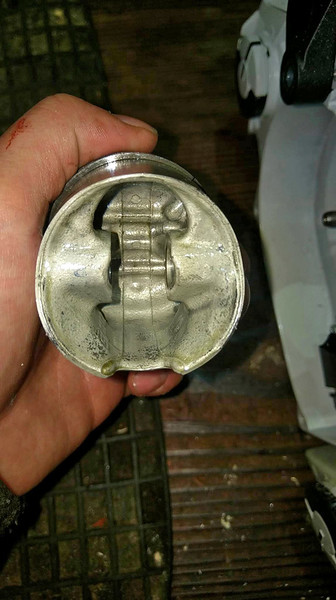

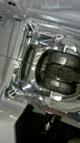

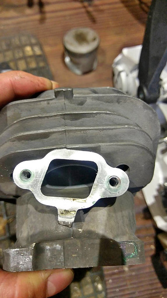

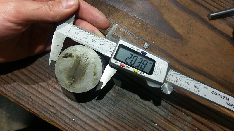

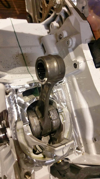

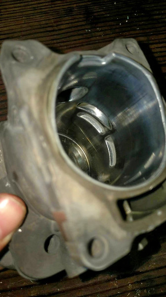

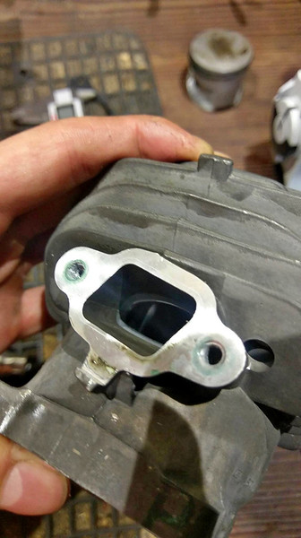

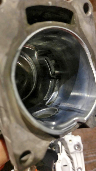

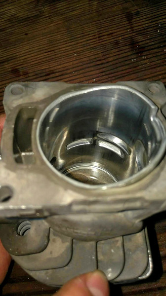

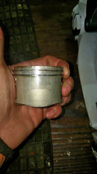

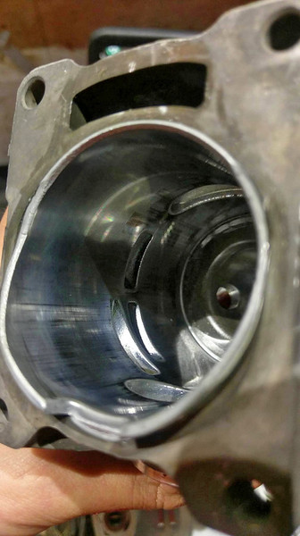

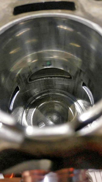

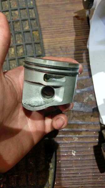

These pics come to us by way of @StephK87 from Germany. He was kind enough to void his warranty and send us these pics. Not only that, he will be porting this saw ASAP and gutting the stratos, Snellerized Style. I can't wait to see how this thing runs! It looks like a cross between a MS261CII and a MS661C.
Stephen's initial comments are that it's as light as a MS362, as strong as a MS461 but with better acceleration, and much better handling than a MS441.
13.18# dry.
I LOVE the dawgs!
Looks like a 661 muffler.
Look at the angle of the exhaust port!
Look at those Dawgs..my gawd it's sexy
