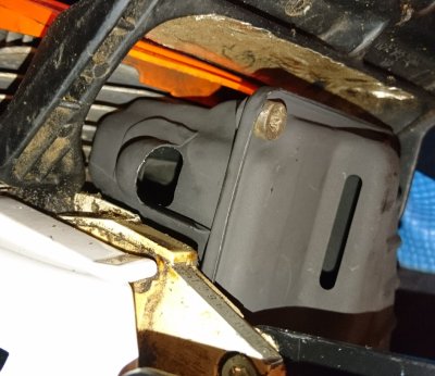

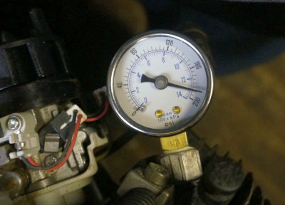

You could maybe do a squish adjustment and more aggressive porting. But I never participated in the porting wars myself, so adjusting the squish when she puts out over 180psi seems a bit much to me. I am sure Randy or whomever could do much better. My main point was sometimes with an M-Tronic saw, a little mod goes a long ways.
Having said that, I do think removing the baffle and enlarging the exit on that muffler and saw combo was a HUGE difference. The sound pressure goes up insanely. Almost as though it has no muffler. Not sure it came across as well in the videos. It really is a massive difference, and the saw starts to pull much more strongly. Again, maybe it's the air here, or maybe the mufflers were different from what others had, because the muffler mod is surely different - I haven't heard of anyone else ever removing the baffle.

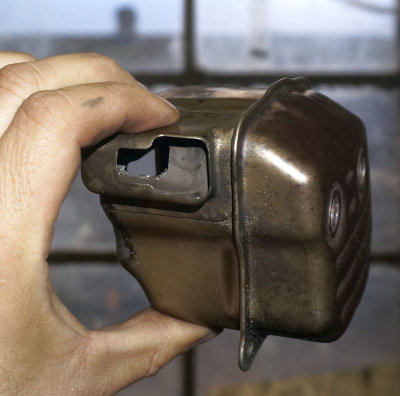

I have a 261 muffler on my bench and it has a very discreet baffle, at a glance it looks like a hollow can...I cut through one with a burr on a stock 261 I had and I'll agree it wasn't but a tick or so behind a woods ported saw.
I think that may be it. I hear from a lot of folks they don't have a baffle. But if you look at the stock muffler through the exhaust outlet you obviously can not see the muffler inlet, which you should be able to see if there were no baffle. The baffle forces the exhaust to go to the front of the muffler, bounce off 180*, with some of it exiting out the top outlet, and some of it reflecting back into the exhaust port of the cylinder. It's basically a partition/divider. Once removed, which takes a bit of effort unless you can separate the muffler in two, the exhaust has a straight shot of less than a couple of inches directly out of the muffler. At this point, enlarging the stock muffler outlet makes a much bigger difference in performance. Another thing I started doing after I saw how well it worked was adding or enlarging muffler exhaust ports as close as I possibly could to the cylinder exhaust port - which is usually simply the first baffle on most saws.

I think the issue with the 261 muffler is the baffle is nearly flush with the top of the exhaust port from the cylinder, and is basically a big shelf. So it is forcing the pulse from the cylinder down as much as forwards VS up the instant it leaves the cylinder. Because of this, you have a lot of exhaust deflected off the bottom of the baffle towards the bottom of the muffler, causing a great deal of turbulence and back pressure immediately in the path of the exhaust port, with very little of the initial energy pulse forcing the exhaust out of the tiny muffler port. That also means a simple MM done after the baffle isn't making nearly as much an improvement as it would with the baffle removed as all that exhaust and pressure has to fight it's way through all the turbulence to find the other port. With the baffle removed and muffler port opened, not only can the gases flow out of the muffler immediately in all directions, hugely reducing turbulence and pressures, but any pressure pulses are immediately diffused into a much larger, lower-pressured area(AKA the atmosphere) nearly the moment the piston opens to the muffler. It's very easy to tell how stopped up the muffler is when you do this because the dB increase is rather dramatic.
I never really pursued this much on the forums before because so many people stateside told me they saw no baffle in theirs. I just assumed we were lucky in Europe to get great gains for relatively little work. And if I wanted to nearly halve the cut times, I just could throw a bit of porting on top. After all, so many euro mufflers seemed to be much more restrictive than many of the other ones I had seen; the 044 comes immediately to mind. Once you place a DP and gutted muffler on an 044, it really comes alive here. This is a pic of one on my personal 10mm saw:
