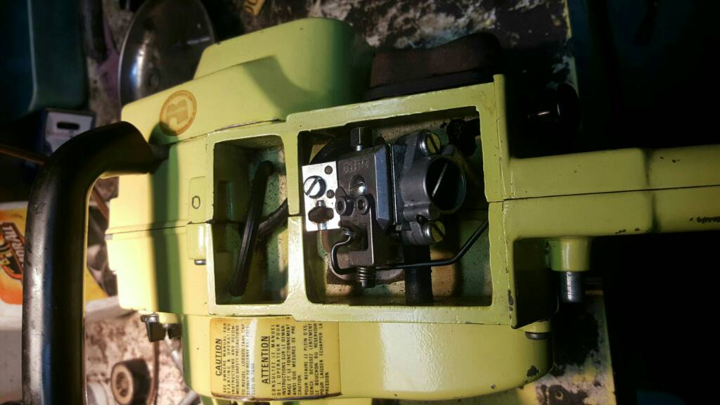

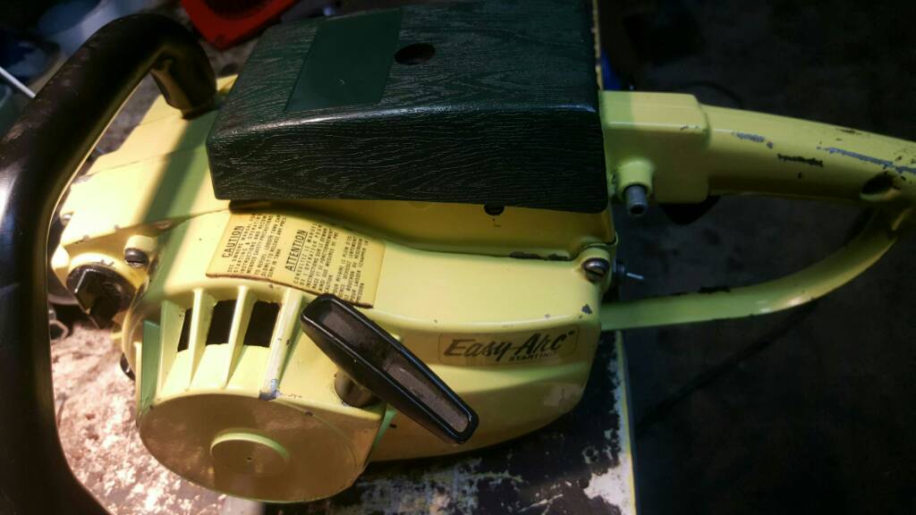

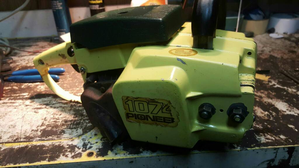

Just finished this 1074 easy arc. The recoil was messed up a little but was an easy fix. Needed a good cleaning. Fuel lines were still good so I put some fuel in it and it fired up in a couple pulls. Sounds pretty good. I'll try and make some cuts with it this weekend.
