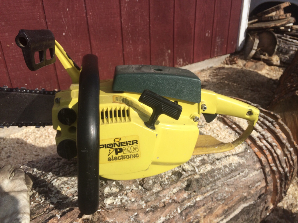

Pretty good shape other than the typical cracked air cleaner and I'll get some picks up later.
Dang those air cleaner covers, someone might chime in that has a spare. If not watch ebay and maybe chainsawr.
11:20 AM
I've been looking it is my buddies saw I cleaned it up and did a little hack job on the air filter over the summer . I was thinking of putting an elbow and air filter set up of a jred 2145 and calling it a Western Jr.

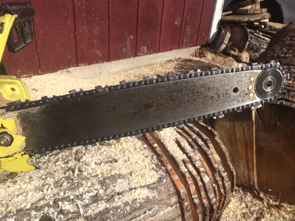

My resident P-26.
.325" x 16" on roller nose bar.
11:20 AM
I got 16.5 ? .325 no roller.
Nice and clean saw, it would be kinda cool to put a elbow and small v-stack on it.
