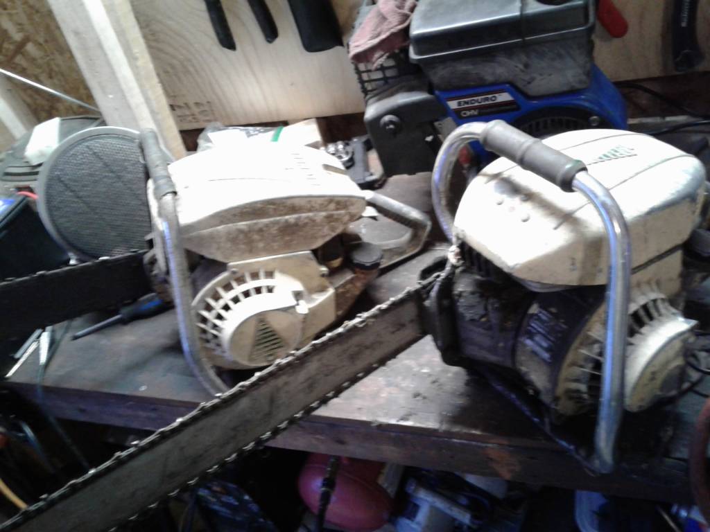

I got these couple old pioneers i am thinking about restoring. 600 and a 620.
The 620 will be first in line. First i got to figure out cleaning out the gas tank. Its all full of varnished goo crap stuck to walls of tank.
Also any advice on tearing these things down will help too. Im kinda wondering about if i should take the cylinder off to clean real well. Im woried about the gaskets tearing.

All gaskets on the 600 series saws can be made by hand, not difficult at all. NAPA has some good product to dissolve the gunk in the fuel tanks, comes in 4 liter cans and will leave the mag tanks shiny clean, no need for agitation.

You wouldnt happen to know whar the stuff is called at napa that will disolve the crud in tank.

I had picts ,before photo bucket and picassa kidnapped them, of tanks on RA`s and 600 Pioneers that had even fuel lines melted to slimy goo basically welded to the mag tanks, the Kleen Flow would clean the tank shiny clean just sitting overnight on the bench. I have not used it in plastic tanks yet but would give it a try if I found one that crudded up.
