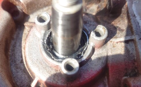

The farmertec/stihl puller was able to grab the crank side, but the flywheel side just opened up on me...
Now I guess it's time to make a custom pick to try and pry this thing out...
Use a flat screwdriver or small flat punch and slightly fold the metal edge of the seal in toward the crank shaft all the way around the pocket. Then at one spot, fold the metal edge in all the way but don't touch the crank! the drill a small hole in the folded metal ring and install a sheet metal screw. Pry the wrecked seal out with the screw and needle nose pliers or whatever you have to pry under the head of the screw. Just be careful not to ding the crankshaft in the process.
